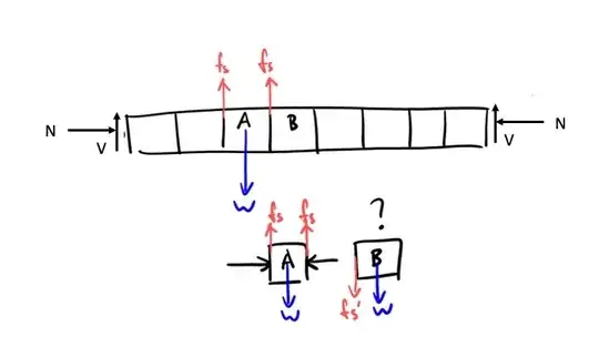

The following is what I have figure out till now
If we were to draw the free body diagrams of the block A and the 2 blocks to the right of it, it would be as shown by Farcher's answer as follows and we can similarly draw the 2 blocks to its left as well
The problem I have with this is, it seems to suggest that the friction force between the blocks at the end is greater than the friction force between the blocks near the center. So, the end blocks are closer to the limit of friction than the central block. So, if I were to ask the question as to which block can support more additional weight on top of it before the structure collapses, this would seem to suggest that the central block A would be able to support a higher additional weight than the end blocks before it all collapses, since the friction force on its surfaces are lower and hence have more leeway before they reach the threshold friction limit
But from intuition, if the whole thing was on top of lava, and we were told we could choose to stand on any one of the blocks, would the central block not be the one block that we would want to avoid? Which is wrong here? Does the free body diagram drawn here have a mistake or is it simply a flawed intuition and will the central block indeed be able to support more weight than the end blocks?
In short, if the whole structure was on top of a lake of lava, would we be actually better off choosing to stand on the central block (even though my intuition says we would be safer standing on the blocks near the ends)?

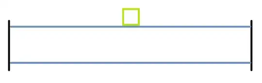

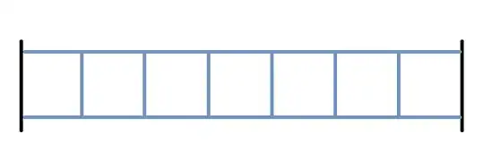

The blocks are a distraction. You can take an intuitive shortcut to solve the problem.
Let us replace this problem

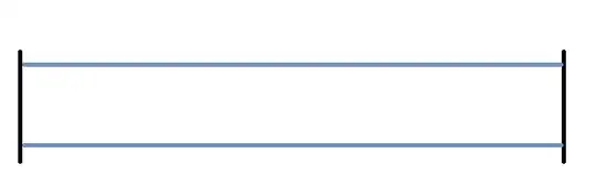

with this one
Either way, the total weight is $N \cdot W_{block} = W_{board}$. The upward force of friction on each end must be $W_{board}/2$.

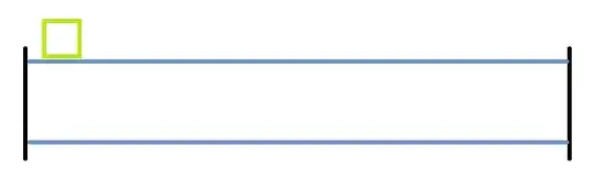

Now you are added to the board. If you are in the center, the weight on each end is $(W_{board} + W_{you})/2$.
If you are near the left end, the forces of friction must be approximately $F_{left} = W_{board}/2 + W_{you}$ and $F_{right} = W_{board}/2$. $F_{left}$ is bigger than before. So this configuration is more likely to fail. Standing on the center is safest.

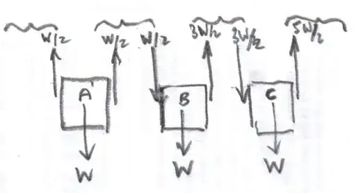

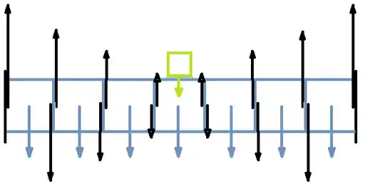

Previous answers have shown that the upward force of friction must be just strong enough to hold up the weight of the blocks. Outer blocks must hold up inner blocks. So the outermost blocks have the highest friction forces.
Here is a diagram that shows the forces on each block when you are in the center. Note that the upward forces on the center block are big enough to counteract $W_{block} + W_{you}$.
I don't want to solve a homework problem completely. Can you see how it would change if you were centered over the left block?

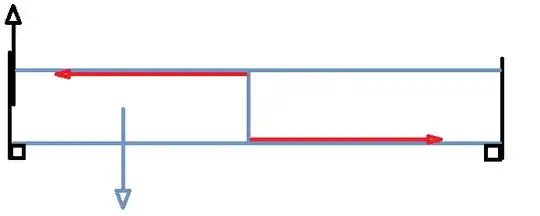

The intuition that the center is the weakest is perfectly reasonable. If you laid a plank across a gap, the center would be the weakest. But that is a different situation that this.
A plank would break if the force became to big. We can understand this in terms of torques. Consider the plank to be two half planks strongly attached to each other. Each half does not rotate if the total torque on it is $0$. We suppose the ends are supported well enough that they do not move. See Toppling of a cylinder on a block for more about this.
This shows the forces on the left half plank.
The blue force is the weight of the half plank. The black force is the reaction of the support holding half the weight of the plank. If the other half plank was not present, this torque would rotation the left half clockwise.
But it is present. The top of the left half cannot rotate without compressing both itself and top of the the right half. The two halves press against each other strongly. The top red force is the force the right half exerts on the left.
The bottom is under tension. The two halves pull on each other. The bottom red force shows the right have pulling on the left.
The plank breaks if the red forces are stronger than the internal forces that hold molecules together.
This diagram is an idealization. The red forces would really be distributed through the interior of the plank, much like the weight is really sum of the weights of each atom.
A perfectly rigid plank would be entirely under compression. A real plank would sag. The amount of compression and tension would depend on the amount of sag. For example, a plank made of taffy or like a slinky would be entirely under tension and would sag into a deep U shape.
Suppose you stand on the left half plank. You add a torque that the plank must resist.
If you stand near the support, most of your weight is held by the left half. But the torque is small because the distance from the support is small. You maximize the torque by standing in the middle of the plank.

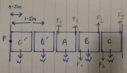

As mentioned in the question, the friction force on the end block, $F_3$, is most likely to be near limiting friction. In reality the beam would bend, but if we presume that it fails only due to the limiting friction force being exceeded, it'll happen like this:
Farcher found that $F_3$ is $\frac{5W}{2}$. We can get the same result by doing moments around point P.
Without the person (of weight $kW$)
$0.5W+1.5W+2.5W+3.5W+4.5W - 5F_3=0$
$F_3 = 2.5W$
Person standing on block A
$$0.5W+1.5W+2.5(kW+W)+3.5W+4.5W - 5F_3=0$$
$$F_3 = 2.5W + 0.5kW\tag1$$
Person standing on block B
$$0.5W+1.5W+2.5W+3.5(W+kW)+4.5W - 5F_3=0\tag2$$
$$F_3 = 2.5W + 0.7kW$$
Person standing on block C
$$0.5W+1.5W+2.5W+3.5W+4.5(W+kW) - 5F_3=0\tag3$$
$$F_3 = 2.5W + 0.9kW$$
$F_3$ is lowest for block A, so it's safest to stand on block A.
It just remains to check that $F_1$ and $F_2$ are lower than this. When on A the two $F_1$ forces support the person and one block
$$F_1 = 0.5W+0.5kW$$
and the two $F_2$ forces support the person and three blocks
$$F_2 = 1.5W+0.5kW$$
both are lower than $F_3$, so A is safest.

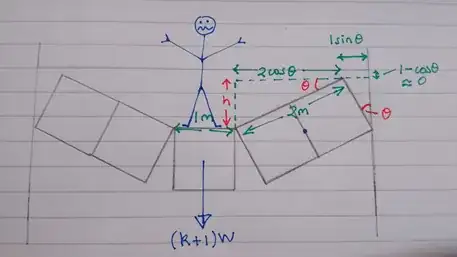

Part 2) Collapse due to cracking.
It's now assumed that the walls can be forced back enough to give room for the bridge to collapse.
As a crack starts and grows, the total horizontal length of the bridge increases and work is done by gravity to force the walls further apart.
At first, as block $A$ drops a very small distance $h$, the total horizontal length of the bridge becomes $1+4\cos\theta + 2 \sin\theta$ and $\sin\theta = \frac{h}{2}$. For small angles $\cos\theta = 1$, so the increase of the length of the bridge is $1+4+h-5 = h$. The walls are forced apart and work is done against the compressing force $N$, there might also be a gain in kinetic energy , $K.E.$.
There is a loss of gravitational potential energy of $(k+1)Wh + 2\times2W\frac{h}{2}$
$$(k+1)Wh+2Wh = Nh + K.E.$$
There can be spare energy for kinetic energy, i.e. a downward movement if
$$N< 3W + kW\tag4$$
(when a person stands on block $A$).
If we compare this with the 'friction collapse' formula (1), that is equivalent to $$\mu N < 2.5W + 0.5kW\tag5$$

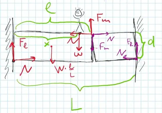

There are two types of instabilities that can occur in the system. The first one is the is the insufficiency of the friction force to prevent the bridge from sliding down (which is what people mostly considered here). The second type of instability is the failure of the normal forces to supply the necessary torque. This instability was not considered by other people here and that's what this answer is mostly about.
Concerning the friction force failure, as many people noticed, the highest demand onto the friction force is at the edges, and the closer the person is to the wall, the larger portion of the person's weight that wall is going to carry, and the easier the friction at that wall is going to fail. To prevent this kind of instability it is better to stand in the middle, to let both walls share the same portion of the weight.
As of torque instability, consider a very similar problem to the OP's. Suppose the bridge consists of only two blocks of unequal length $l$ and $L-l$ installed exactly like on the picture: enter image description here
This problem is very similar to the original problem with blocks, but some of the cubes are effectively "glued together". Even if the friction coefficient is arbitrarily high, such system can still break by forming a crack between the blocks, and both blocks "flipping down", like on the picture. The stability of the original system of many cubes can be analyzed by looking for the weakest point, i.e. by looking for the easiest place for the crack to form in the two-block picture.
In the system of two blocks, there is a maximum weight of the guy the bridge can carry. We can find the maximum weight by writing down the balance of torques and forces for the two blocks. The following system is the two zero-torque equations around the bottom corners of the blocks that push against the wall (left and right correspondingly): $$ \begin{cases} -W\frac{l}{L}\frac{l}{2}+Nd+F_m l-x \omega=0;\\ -W\frac{L-l}{L}\frac{L-l}{2}+Nd-F_m (L-l)=0; \end{cases} $$ Here $W$ is the total weight of the bridge, $N$ is the force we squeeze both blocks with, $d$ is the height of the bridge and $x$ is the position from the right where the person stands. Solving for $\omega$ yields $$ \omega=\frac{l}{x}\left[Nd\left(\frac{1}{l}+\frac{1}{L-l}\right)-\frac{W}{2}\right].\quad (1) $$
For a fixed crack position $l$, the critical weight $\omega$ is larger the smaller the $x$ is, i.e. the further from the crack the person stands. In the case where there are many places for the crack to appear (as in the case of cubes), it is safer to stay away from all cracks (which goes along with the common sense). Also, as one can see, if $x\rightarrow 0$, the maximum weight is going to infinity, which makes sense, since the person does not create any torques around the pivot point at $x=0$.
We can also notice that if we are standing on a crack, i.e. $x=l$, the critical weight is $$ \omega=Nd\left(\frac{1}{l}+\frac{1}{L-l}\right)-\frac{W}{2},\quad (2) $$ which is the smallest for $l=L/2$, and increases towards the edges. In other words, cracks near the edges are safer.
Interesting. We see from Eq. (1), sometimes the right part of the equation may get negative, which means we have to support the bridge in order for it to not fall apart. If the number of cubes is even, the weakest crack is in the middle, and for $W>8N d/L$ the bridge is going to fall apart by itself.
To summarize everything so far: we have a competition of two instabilities: one is the friction instability, for which it is safer to stand in the middle of the bridge. Another instability is the torque instability, for which it is safer to stand near the edge. Determining which of the two is more important in general case is quite involved, because the answer will depend on the ratio of $N/W$, on friction coefficient $\mu$ and on the total number of cubes.

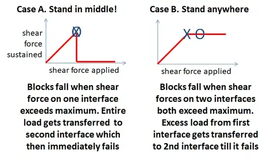

[Edit: I'll leave this answer for interest, but it addresses a different situation where the blocks are supported by a force applied through two vertical walls separated by a fixed distance.]
The answer depends on the form of the friction force vs. applied load at each interface: Friction force vs. applied shear force
The assumptions are that the blocks are perfect cubes and can only move vertically. At each interface between blocks there is a given normal compressive force that is the same for all interfaces and consequently a given maximum friction shear force that can be sustained by any interface. The actual friction shear forces (and the moments present) are different for each interface. The bridge fails only if the shear force exceeds the maximum value on two interfaces in which case all the blocks between the two interfaces (plus anyone standing on them) fall to their doom in the fiery lava!
The answer depends on the form of the friction force vs. applied load at each interface. Two extremes are shown above. In the left picture, the friction force disappears entirely if the applied force exceeds the maximum. In the right picture, the friction force simply stops increasing when the maximum is reached. Real systems act somewhere between these two extremes.
In case A, the blocks fall as soon as the shear force on one interface exceeds the maximum because the entire load suddenly gets transferred to second interface which then immediately fails. So standing on one end of the bridge is a bad idea. The force will be a maximum on that end interface which will fail and transfer the full load to the far-end interface which will also necessarily fail.
In case B, the blocks will fall when the shear forces on two interfaces both exceed the maximum. When the first interface reaches its maximum, the excess load will be transferred to the other interfaces. (The moments across the interfaces will readjust accordingly as the forces shift.) The system will not fail until a second interface also reaches the maximum load. The total load (blocks plus person) cannot exceed twice the maximum friction force. It doesn't matter where the person stands.
