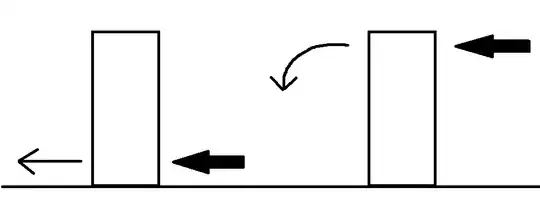

When I'm pushing a tall, cylindrical object stood on its end (like a Pringles can) I can push it near its bottom, and it will slide forwards, or push it near the top, and it will topple over.
topple VS move
So, there must obviously be a point somewhere on the side of the cylinder where it stops moving forwards and begins falling forwards.
My question is, how can I calculate where this point occurs?
It might be something fairly obvious, like: "above the center of mass" or something like that, but I'm guessing that it's something more complicated, taking into account friction, etc.
