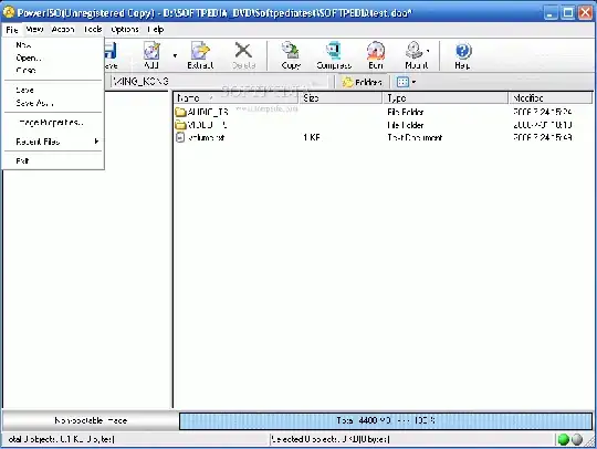

It's very simple. We will go step by step...
  • By using PowerISO.
  • First download and install PowerISO.
  • Open PowerISO.
  • Then click on FILE and then on OPEN and browse and open the ISO file.
  • When you have opened that ISO file if that file is bootable then in the lower left end, it shows "Bootable image". If not a bootable image, then it shows "Nonbootable image".
