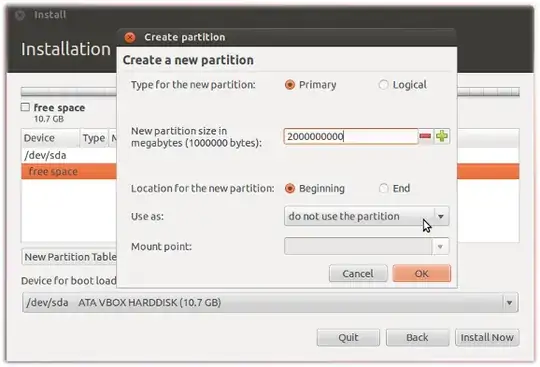

We then need to tell gparted the erroneous sectors assuming they are really at the beginning of the drive by selecting Add... and then choosing don't use the partition:

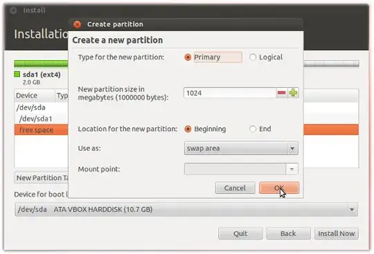

After that we may create the remaining partitions to hold Ubuntu, namely the Swap partition (in case we really need one):

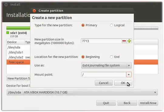

And then at least the root partition (/) to hold the system files. We may also add a separate /home partition here (but this is not really needed anymore):

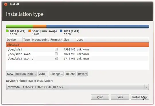

After we have set up the partition table we proceed with partitioning, formatting and installing Ubuntu to this drive by pressing Install Now:
