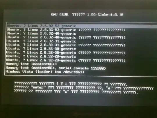

Yesterday I decided to update my system from 10.04 LTS to 12.04 LTS. I downloaded desktop ubuntu for i386 .iso and made a liveUSB(using UNetbootin). I choose Try Ubuntu without installing and there I run install and choosed Update Ubuntu from 10.04 to 12.04. And at the begining of the update system just stucked and I made reboot.
And now GRUB looks like this enter image description here

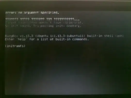

And when I try to choose ubuntu instead of loading it there appers messages like enter image description here
I tried to check and fix partitions using GParted from LiveUSB and treid use sudo fsck.ext4 -f /dev/partition_on_disk. But all thing still the same. What else can help? Also I tried update GRUB but nothing changed too

  • Boot ubuntu live usb and run install.Don't choose update from ubuntu 10.04 to 12.04,choose something else option.Select the ubuntu 10.04 partition and format it to ext4 filesystem.Then choose the same partition to install ubuntu 12.04.
