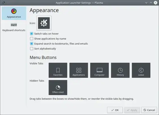

How an older configuration file will affect performance depends on a variety of factors, such as which application launcher you are using. For example, are you using Application Menu (kicker), Application Dashboard (kickerdash, the full screen launcher), or Application Launcher (kickoff)? You can switch between them with right-click → "Alternatives...". Are they all equally enslowed? Does this change if you alter the settings?
You can try toggling settings like useExtraRunners ("Expand search to bookmarks, files and emails"). You can change this via right-click → "Application Menu Settings..." or "Application Launcher Settings...". Here's what it looks like for Application Launcher (kickoff):
Application Launcher Settings -- Plasma

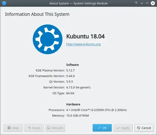

It would be helpful to have a screenshot of your "About System" screen, like this:
About System -- System Settings Module
This would provide information about the exact version you are using (useful for other folks who read this question) and some basic hardware information.
