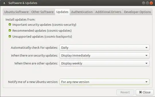

  1. Make sure that you have the following contents in the /etc/update-manager/release-upgrades:
    Prompt=normal
    or from Software & Updates (software-properties-gtk) GUI tab Updates:
    for any new version
    set Notify me of a new Ubuntu version to For any new version.

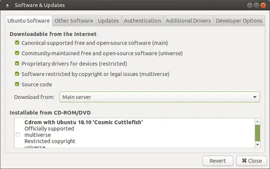

  2. Switch to the Main server in Software & Updates (software-properties-gtk):
    main server
