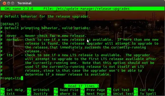

Open the /etc/update-manager/release-upgrades with your favorite text editor, ie:
sudo nano /etc/update-manager/release-upgrades
Change the Prompt= line from Prompt=foo_setting to Prompt=never.

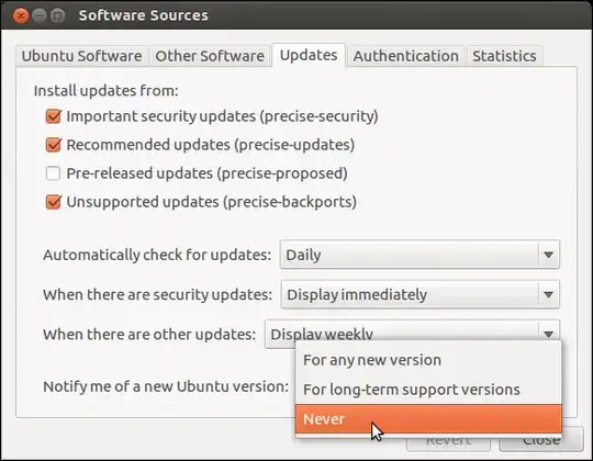

If you want a graphical way of doing it open the Ubuntu Software Center and under Edit > Software Sources > Updates you will find a Notify me of a new Ubuntu version option, from the drop box select Never.

To stop Ubuntu nagging you:
Change Prompt=normal to Prompt=never:
To exit nano press the combination CTRL + X and then answer to the question of saving changes with Y.

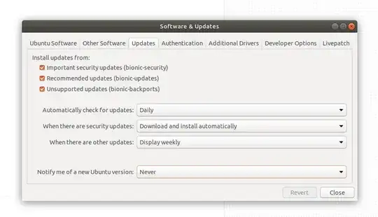

On newer versions of Ubuntu, using the GUI, you should see an option
Notify me of a new Ubuntu version, therein select Never
