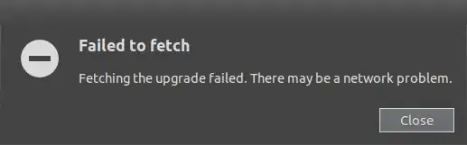

If I then ask for the upgrade I get this error message:

Failed to fetch
Fetching the upgrade failed. There may be a network problem
The message may indicate that you need to check your connection or the upgrade servers. They may be down for the moment. But it actually means that is trying to upgrade to 14.10, instead of 15.10 or 16.04 LTS, which is EOL and therefore the packages are missing on the server. I would suggest to open a bug report against ubuntu-release-upgrader-core or contact the Release team, as this shouldn't be the behavior of the upgrade manager.
