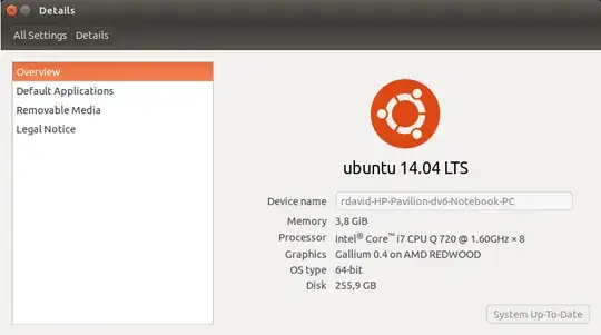

Check the version of Ubuntu
You can check what Ubuntu version you have by typing lsb_release -a in terminal.
OR
Open System Settings -> Click on Details and you can see the version under the Ubuntu logo.
Ubuntu 14.04 Long Term Support System Details
