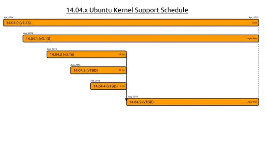

As it appears in this picture the versions of 14.04.X will have different version of the kernel so 14.0.4.1 will continue with the kernel of V3.13 till April 2019 while 14.04.2 will have 3.16 for 18 months then to be upgraded to 14.04.5 with the version of kernel o be applied then
For more info kindly check this Source
14.04.X Kernel Support Schedule
however if you still want to upgrade to 14.04.1 you may download the ISO Image from this LINK and perform Upgrading by using the CD image

You did not quite understand it. 14.04.2 is LTS. It is just a service release of 14.04. Shorter life is only for kernel version, but it can be upgraded later. So just upgrade to 14.04.2.
