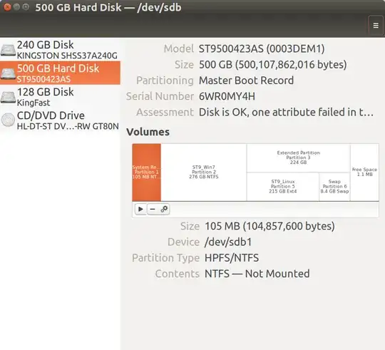

Select the drive of interest then click on the menu button at the upper right corner and choose SMART Data & self tests

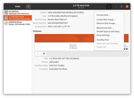

Note that sometime between 18.10 and 20.04 the menu option has moved from the "hamburger menu" to the 3 vertical dots menu as shown below.
