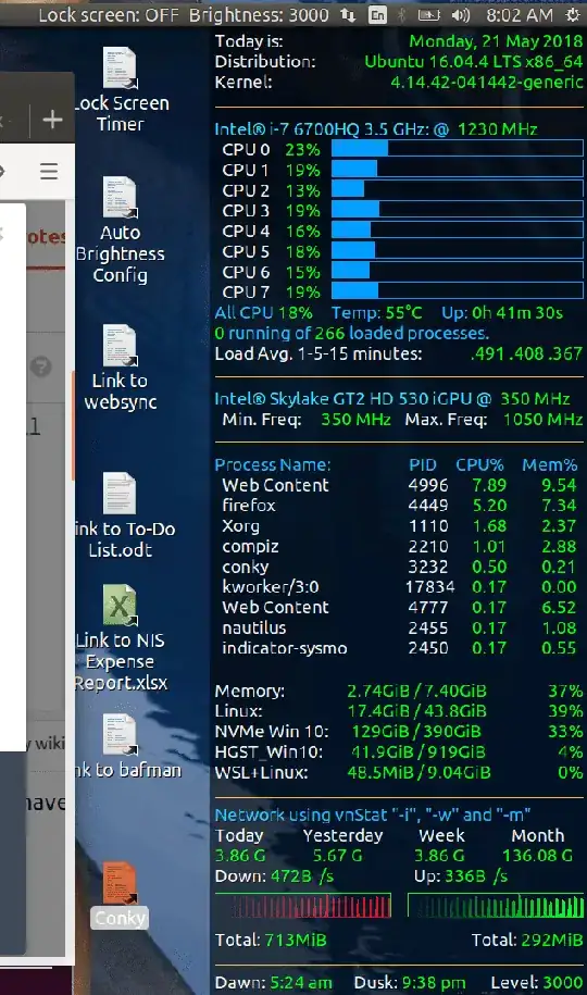

System Monitor on desktop with conky
Many people like to show their system status (and health) on a portion of their desktop. I like to keep my Conky running on the right 20% of my primary monitor:
Note: The 97% CPU usage on single CPU is caused by screen recorder itself.
To learn more about conky and CPU usage see: How do I stress test CPU and RAM (at the same time)?
