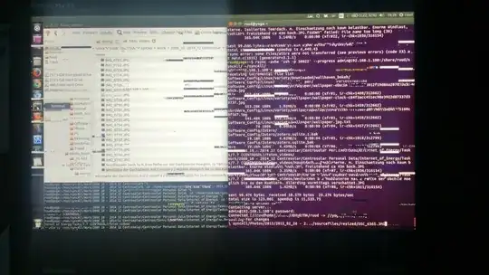

The crashes usually cause visual artefacts on the screen; see screenshot: enter image description here

Rule out drive issues by check Smart status of the drive(s) as outlined on this page
Run memtest86 to rule out memory errors as described here. If you have an EFI system you'll want V5 or later which support EFI boot. The latest version is available here
