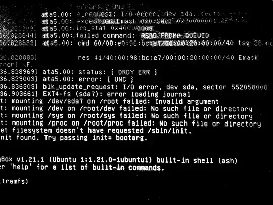

I have an 8-year-old dual boot laptop, but it won't start Ubuntu or Windows. When selecting Ubuntu, I get a BusyBox, that mostly says:
failed command: READ FPDMA QUEUED
blk_update_request: I/O error, dev sda, sector 552058008
Are there any software solutions or is this machine doomed?

I did the smart check via a live CD, and when I first visited the Disks, the /dev/sda was OK, with 57 bad sectors. After running a short and a conveyance, the test failed:
Does that mean that me disk is dead?
All the attributes have an OK assessment in the smart test, so there might be hope. Moreover, if I choose "Check disc for defects" from the live CD, it completes, with no errors found.
In this case the disk is not ok. It's at best dying, and depending on where the sectors are they may effectively make the disk unlikely. The bad sector count will not go down; it will only increase - often relatively fast.

The disk is likely beginning to fail. The SMART test has failed in many ways and the system is reporting IO errors in kernel panics, etc.
Also, this is not a safe command to run:
dd if=/dev/sda of=/dev/sda
That command will read every byte from the disk and write it back to the disk, which is at best useless and at worst destructive.
Another command you can run to likely verify the disk is broken is:
sudo apt install debsums
sudo debsums -s
If anything is printed by the debsums command it means that system files on disk have been corrupted.
