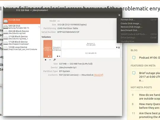

Why is that? It is ok for the 2nd drive which is external usb ssd.

From How can I check the SMART status of a SSD or HDD on current versions of Ubuntu 14.04 through 18.10?:
SMART option greyed out
This can happen with NVMe SSD's. You need to install NVMe SSD specific SMART tools:
sudo apt install nvme-cli
Then run the program to report health of drive:
$ sudo nvme smart-log /dev/nvme0

The most important data point is:
percentage_used                     : 0%
When it hits 100% it is time worry about replacing your drive. That said this drive is two years old and still at 0%
NVME Support was added to smartmontools starting from version 6.5. Please note, that currently NVMe support is considered as experimental.
You can check your current version with the command apt-cache policy smartmontools
The latest version for 16.04 LTS in the repositories ATM is 6.4+svn4214-1 which doesn't have this feature. However it appears that the versions available for artful, bionic and cosmic do have it. Newer packages can often be found here. Alternatively, you can install from source or try a daily build.
For more details on the current status of NVMe support in smartmontools check the wiki.
Info on USB SMART support in smartmontools can be found here.

Not all USB adapters support SMART. I have 2: one of them supports it, the other one not. Both of them USB3

In my computer I have
  • an nvme drive
  • Lubuntu 18.04.x LTS with
    • Disks version 3.28.3 - the "S.M.A.R.T. data self test" is greyed out.
    • smartmontools version 6.5+svn4324-1 - the "SMART overall-health self-assessment test" works.
So I suggest that you install the package smartmontools and use the tool smartctl.
