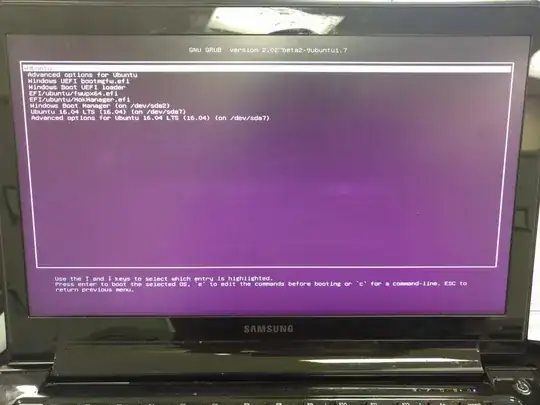

The easy way of recovering from an interrupted kernel upgrade due to battery running out of juice is to:
  • ensure the laptop is connected to mains power now and every kernel upgrade you do in the future!
  • hold the Shift while booting and on the following screen: Ubuntu advanced boot screen
  • take "advanced options"
  • boot into the second-to-last kernel
  • do sudo apt dist-upgrade again.
Done! :-)
