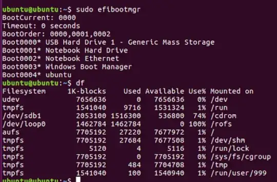

Update #3:
Here are the results of sudo efibootmgr and df in Try Ubuntu with USB plugged in.
<code>sudo efibootmgr</code> and <code>df</code> in Try Ubuntu

You can change the boot order using the -o option to efibootmgr, as in:
sudo efibootmgr -o 4,0,1,2
This example should keep the existing boot entries shown, but add the ubuntu entry to the front. In theory, this will make GRUB the default boot program, and everything should then start working. You can learn more about efibootmgr by typing man efibootmgr. (The same trick works for other commands; for instance, man ls will tell you about the ls command.)
That said, the fact that you had a non-existent BootOrder variable at the start makes me skeptical this will work; I suspect there's something flaky about your EFI that will cause it to fail. (Both the original Ubuntu installation and Boot Repair should have added the ubuntu entry to the start of the BootOrder variable, assuming they were run in EFI mode -- and the Boot Repair output you showed revealed no BIOS-mode boot loader on your disk, which implies they were run in EFI mode.)

It looks like boot-repair did add the ubuntu shimx64 boot entry as item 0004 in the last run of efibootmgr in your paste link. 0004 was missing in the earlier runs of efibootmgr (in your paste).
Edit VVVV
Your latest manual run of efibootmgr however does not have 0004 in the bootorder, even though the item is listed. Add it yourself:
sudo efibootmgr --bootorder 0004,0000,0001,0003,0002
Leading zeros are optional, but the above uses the entries as they are shown.

The rename is the file on the hard disk. Your df shows that the hard disk's EFI, sda1, is not mounted anywhere, so until you mount it, you cannot even see the /EFI directory which will appear where you mount it. Don't touch anything under the /cdrom directory.
