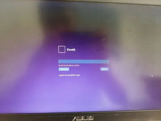

In this state, the terminal is no longer working, meaning that any command (sudo,cd,ls,etc.) ends up in an error. The keyboard shortcuts do not work anymore. If I try to lock screen and then reopen it, I lose the right to access. no_access

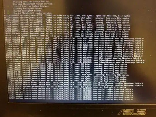

After few minutes, the monitor changes into the following screenno_os and all I can do is hard reset. Alt+Ctrl+F* does not let me change into another command line and Alt+Stamp+K do not reset the os.

The "read-only file system" indicates that Ubuntu had a problem with the disk, and unmounted it and then remounted in read-only mode, as described in https://askubuntu.com/a/197468/283721
You should boot a live USB and run fsck on the disk in question, and you might also check the disk connections, and test the hard disk for errors, as described in How can I check the SMART status of a SSD or HDD on current versions of Ubuntu 14.04 through 18.10?
