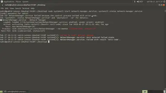

That was when I noticed the WiFi icon had disappeared, so I can’t connect to the internet. I’ve tried connecting to a hotspot via Bluetooth but that didn’t work either (I think that’s a separate Bluetooth issue cuz my laptop is really old). I should also mention that I don’t have access to an Ethernet connection.
What do I do? I desperately need to use my laptop ASAP so some urgent help would be ideal!
I have tried some fixes online where I tried to connect to a WiFi via the terminal but they haven’t worked out either.

Based on the way you've been working around this issue in the past, I would bet money on a failing hard drive being the culprit. At this point the damage may be too severe for a simple fsck to resolve. You might get some indication by checking SMART status of the drive in question. Passing a SMART test doesn't guarantee that a drive isn't failing but failing one is pretty definitive.
