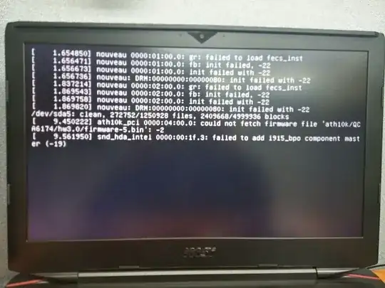

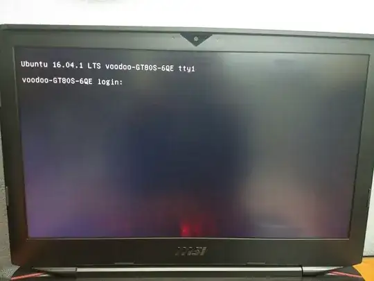

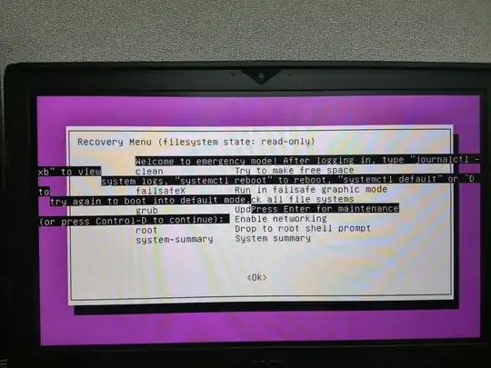

  1. After trying several solutions given in the forums, I ended up installing Gnome as suggested here as Solution 3. After rebooting, the desktop changed to Ubuntu Gnome, but still didn't solve the loop problem. Then I went to BIOS and changed the boot priority to another option, didn't work, then again came back to previous priority and now I can't even access to that login screen. When I switch the computer on I have purple screen suggesting *Ubuntu, Advanced options for Ubuntu, and System setup. Once I hit Ubuntu it goes through some process: screen Then the screen gets dark for about 4 seconds and quickly shows up this: screen Then it goes immediately back to dark screen and again after about 4 seconds the latter screen is shown again. This repeats infinitely.
When I type something, I can see them written after voodoo-GT80S 6QE login: but I can write ONLY AND ONLY when it is shown. If I use Ctrl + alt + f1, I can type for a short time, then it gets dark again. When I hit the power off, it shows:

Based on your lack of concern if you " lose my files or software installed on Ubuntu" and the fact that you can boot Windows via " UEFI with CSM in BIOS" I would reccommend booting from a verified good live media without changing the BIOS from where it successfully boots Windows Once you have successfully booted to the verifed good live media, it would be wise to check the SMART status of your drive to rule out any hardware problem with it that could be impacting your ability to complete installation tasks. Once we have confirmed the following:
1) BIOS mode is set properly to successfully boot Windows
2) Boot into Windows and Turn Off Fast Startup The easiest way to do this is to open a Command prompt as Administrator and issue the command powercfg.exe /h off which will turn off hibernation and fast startup along with it.
2) our live media is uncorrupted
3) our hard drive is in good shape and
4) Verify that the live media is booted via EFI mode matching the mode Windows successfully boots in.
5) We have backed up everything to protect ourselves from unexpected hardware failure and operator error.
Then we can install normally as outlined here.
