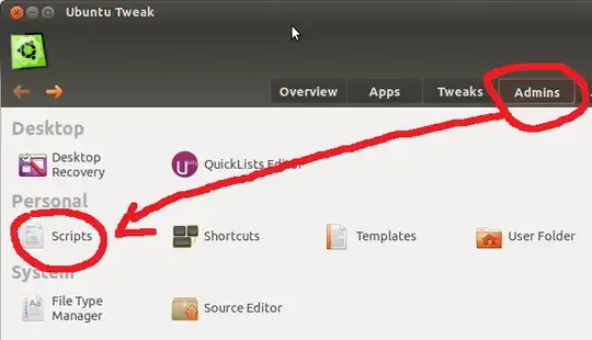

  • Open the Ubuntu Tweak tool from the dash menu
  • Click on Admins tab -> click on Scripts

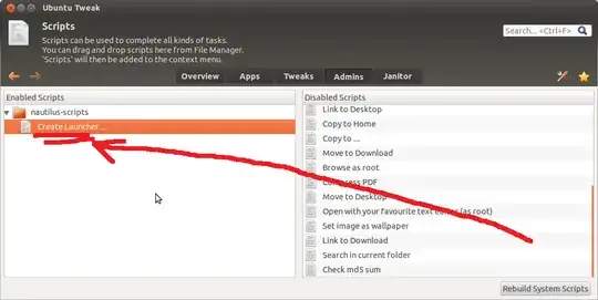

  • You'll see Create Launcher.. at the bottom of Disabled scripts (right column), and drag it to Enabled scripts (left column).

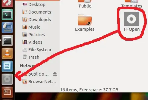

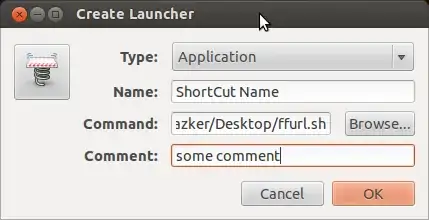

  • Afterwards, go to the location of where you've saved your filename.sh, -> right click -> Script -> Create launcher (which will give you below screen).
  • Fill in accordingly to fit your need (seen above) & make sure to select the filename.sh file by browsing and finish it with Ok. There'll be a shortcut created on the same location where your script file located. Simply drag it and put it into the dash panel.
