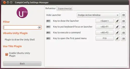

On the Behaviour tab you can configure:
Behaviour tab
  1. The Hide Launcher sets the launchers hide behavior.
    • Never - The launcher will never hide.
    • Autohide - The launcher will hide automatically based on time.
    • Dodge Windows - The launcher will hide when a window would overlay it.
    • Dodge Active Window - The launcher will hide only when an active window would overlay it.
  2. The key to show the launcher which by default is the Super key. This will also affect the key used to show the dash (if tapped) and the shortcuts shown when keeping Super pressed.
  3. The key to put keyboard-focus o the launcher so you can navigate using your keyboard (default Alt + F1).
  4. The key to open a Search Command dash where you can enter a command name you want to execute. (dafault Alt + F2).
  5. The key to open the first panel menu (default F10).

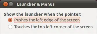

Launcher & Menus (unity-preferences)
There is another option to configure how to show the launcher then it is hidden.
  1. Open the Launcher & Menus configuration utility by pressing Alt + F2 and typing unity-preferences.
    unity-preferences
    • Pushes the left edge of the screen will make the launcher appear about one second after pushing the cursor to the left edge of the screen.
    • Touches the top left corner of the screen will make the launcher appear immediately when the cursor touches the top left corner of the screen.
  2. Select the desired option.

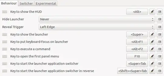

  1. The Reveal Mode sets from which edge the launcher will reveal.
  1. The Edge Reveal Timeout sets the waiting time (in ms) before the launcher is revealed when a window is touching the edge.
  2. The Hide Launcher sets the launchers hide behavior.

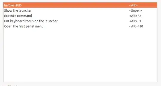

  3. The key to show the launcher which by default is the Super key. This will also affect the key used to show the dash (if tapped) and the shortcuts shown when keeping Super pressed.
  4. The key to put keyboard-focus on the launcher so you can navigate using your keyboard (default Alt + F1).
  5. The key to open a Search Command dash where you can enter a command name you want to execute. (dafault Alt + F2).
  6. The key to open the first panel menu (default F10).

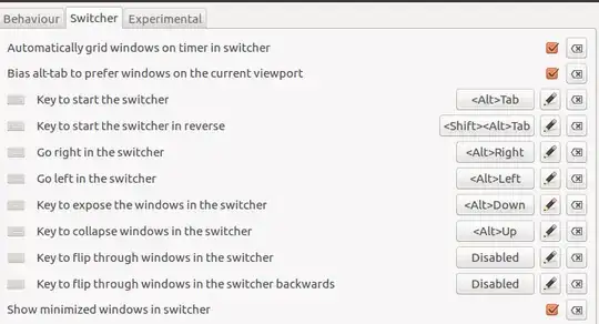

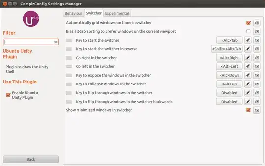

On the Switcher Tab:
  1. Automatically grid windows on timer in switcher: Turn this off if you want don't want to automatically expand multiple windows in alt-tab.
  2. Bias alt-tab sorting to prefer windows on the current viewport: Select this if you want alt tab to prioritize the order in which applications are shows in alt-tab. Applications in your current workspace are listed first.

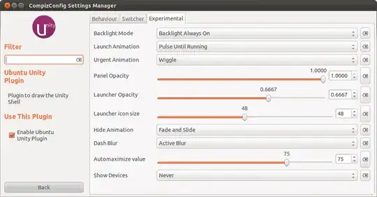

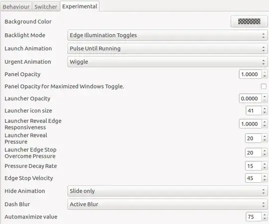

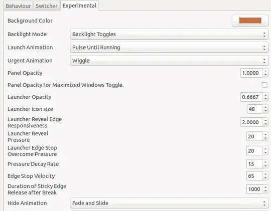

On the Experimental tab (might change hence the name):
  1. The Backlight Mode sets how the icons are back-lit.
    1. Backlight Always On - the icon back light will always be on.
  1. Backlight Toggles - the icon back light will be on as long as the application is running.
  1. Backlight Always Off - pretty much the opposite of the first option.
  1. Edge Illumination Toggles - the edge illumination will be on as long as the application is running.
  1. Backlight and Edge Illumination Toggles - the backlight and edge illumination will be on as long as the application is running.
  1. The Launch Animation sets how the icons are animated.
    • None - no animation will be shown.
    • Pulse Until Running - the icon's back light will pulse till it loads up.
    • Blink - the icon's back light will blink.
  2. The Urgent Animation sets how an icon will inform you of something important.
    • None - no animation.
    • Pulse - it will pulse.
    • Wiggle - it will wiggle.
  3. The Panel Opacity sets the opacity of the panel.
  4. The Launcher Opacity sets the opacity of the Launcher.
  5. The Launcher icon size sets the size of the launcher in pixels.
  6. The Hide Animation sets how the launcher will hide and unhide.
    • Fade on bfb and Slide - fades based on the position of your cursor in the bfb (big funny button - the one in the top left of your launcher with the Ubuntu circle of friends on it) and slides.
    • Slide only - it will only slide.
    • Fade only - it will only fade.
    • Fade and Slide - it will fade and slide.

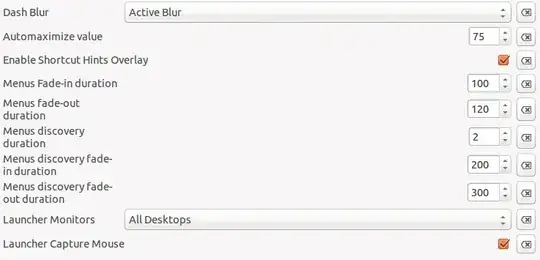

  7. The Dash Blur sets the level of blur in the dash.
    • No Blur
    • Static - snapshot of the desktop that doesn't get updated (in cases where the drivers can't handle it)
    • Active Blur - This means it actively blurs what is behind it.
  8. The Automaximize value sets the minimum value to trigger automaximize.

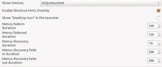

  9. Show Devices sets when to show devices in the launcher.
    • Never - Devices are never shown in the launcher.
    • Only Mounted - Device that are mounted are shown in the launcher.
    • Always - Devices are always shown in the launcher.

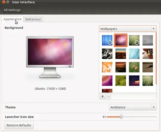

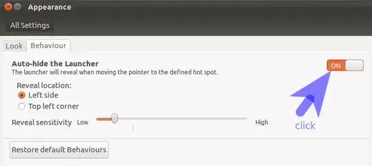

User Interface
  1. Hit the Dash and search for appearance
From the Appearance tab you can configure the:
  • wallpaper
  • theme
  • size of the launcher icons
From the Behaviour tab you can configure the:
  • how to invoke the launcher by moving the mouse (hot-spot) - either left-side of the screen or the top-left corner
  • how quickly the launcher is revealed - lower the slide bar, the longer the mouse needs to be at the hot-spot to be revealed.

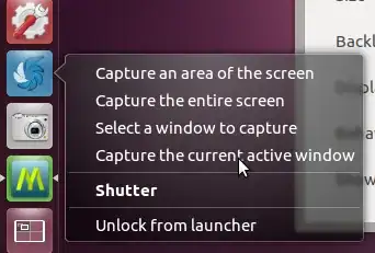

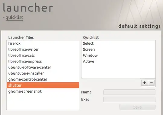

Launcher Quicklists
This option allows you to create quicklists - quicklists are a submenu that are displayed when you right-click a launcher icon.
For example - shutter

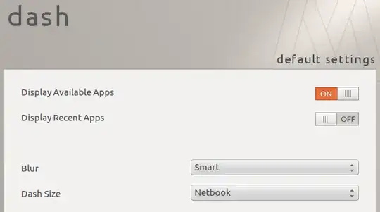

Dash
  1. Display available apps - control whether similar applications from the software center should be displayed
  2. Display recent apps - control whether applications you have recently used should be displayed
  3. Blur - how or if Dash background is displayed - default is to blur the background
    • Off - No Blur
    • Smart - Active Blur - This means it actively blurs what is behind it.
    • On - snapshot of the desktop that doesn't get updated (in cases where the drivers can't handle it)
  4. Dash Size - whether the dash shows in netbook or desktop style depending on the screen resolution

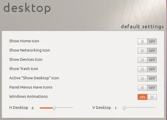

Desktop
  1. This tab determines whether the icons shown in the image appears on the desktop
  2. Window animation - whether the launch and minimize window effect is displayed or not
  3. v desktop & h desktop - controls the number of vertical and horizontal workspaces (default 2x2)

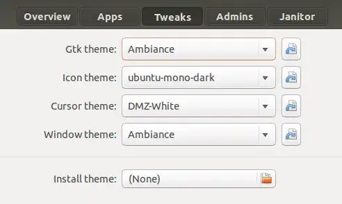

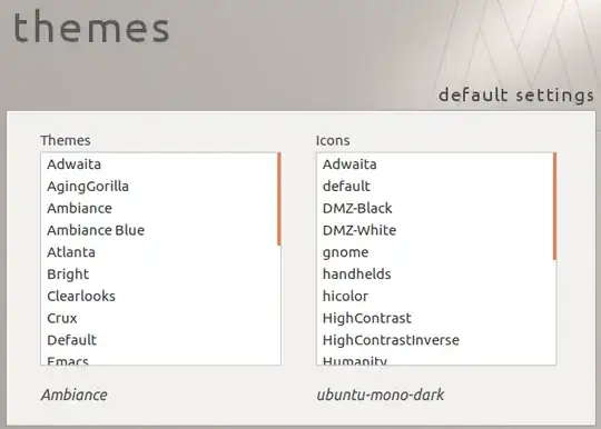

Themes
Any themes that you have installed or manually installed (/usr/share/themes or ~/.themes) together with manually installed icons (/usr/share/icons or ~/.icons) can be chosen.
enter image description here 1. The key to invoke the HUD - Head Up Display - by default this is the Alt key.
  1. The key to show the launcher which by default is the Super key. This will also affect the key used to show the dash (if tapped) and the shortcuts shown when keeping Super pressed.
  2. The key to put keyboard-focus on the launcher so you can navigate using your keyboard (default Alt + F1).
  3. The key to open a Search Command dash where you can enter a command name you want to execute. (dafault Alt + F2).
  4. The key to open the first panel menu (default F10).
  5. The key to define the Application switcher (default Super+Tab
  6. The key to define the Reverse the Application switcher (default Shift+Super+Tab
Switcher tab of Unity plugin in CCSM
  2. Bias alt-tab sorting to prefer windows on the current viewport: Check this if you want alt tab to show only applications in your current workspace, or uncheck it to show all open applications regardless of which workspace they're on.
  3. Show minimized windows in switcher: Turn this off if you don't want minimized windows appearing in the switcher
Experimental tab screenshot 1
Experimental tab screenshot 2
  3. Launcher Reveal Pressure - amount of mouse pressure required to reveal the launcher when the mouse is located at the launcher hot-spot (Decreasing this value causes the launcher to reveal with very light touch of the cursor at the hot-spot or left-side, otherwise you have to travel the cursor a little way)
  4. Launcher Edge Stop Overcome Pressure - amount of mouse pressure required to push into the next monitor
  5. Pressure Decay Rate - the rate at which the mouse pressure decays
  6. Edge Stop Velocity - the maximum velocity at which the mouse will still be stopped
  7. The Automaximize value sets the minimum value to trigger automaximize.
  8. Enable Shortcut Hints Overlay - pressing and holding the Super key displays the keyboard shortcuts overlay. This can be disabled through this setting.
  9. Menus Fade-in duration - duration (in milliseconds) that the global menu fade-in animation takes to display when the mouse moves into the global menu region.
  10. Menus Fade-out duration - duration (in milliseconds) that the global menu fade-out animation to display when the mouse moves into the global menu region.
  11. Menus discovery duration - number of seconds the global menu should display when an application is first started
  12. Menus discovery fade-in duration - duration (in milliseconds) that the fade-in animation takes when the global menu is displayed for an launched application
  13. Menus discovery fade-out duration - duration (in milliseconds) that the fade-out animation takes when the global menu is displayed for an launched application

User Interface
  • wallpaper
  • theme

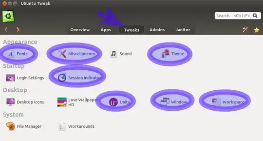

Ubuntu Tweak
  1. Hit Alt+F2 and type ubuntu-tweak and hit enter or choose the Ubuntu-tweak icon found in the Session Settings
You can now configure quite a few different settings, like the Fonts, Themes, Unity tweaks, Window tweaks, Workspace settings, Indicator Session Tweaks
Fonts
  1. antialiasing - how smooth the fonts are displayed
  2. hinting - adjust the display of the outline font
  3. font options - change the font for the desktop type
  4. Text scaling factor - scale the text font size by the given value.
Themes

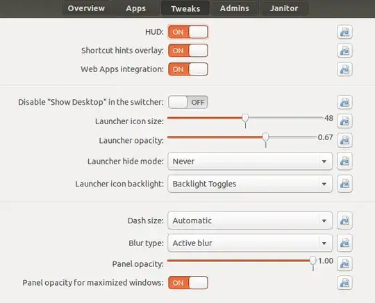

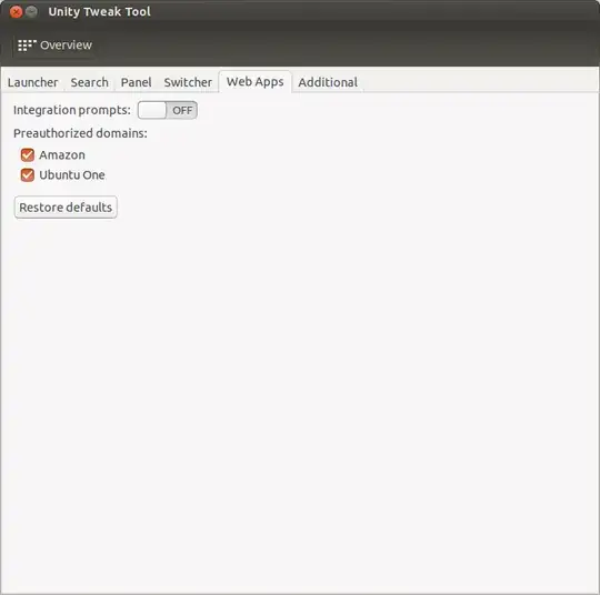

Unity Tweaks
  1. HUD - Turn the Head-Up-Display on/off
  2. shortcut hints overlay - turn on/off the desktop short cuts display shown when pressing and holding Super
  3. Web Apps integration - turn on/off the HUD integration with various Web Apps enabled sites such as Google Apps, Facebook & Twitter
  4. *Disable "Show Desktop" in the switcher - hide the desktop icon displayed when Alt+Tab
  5. Launcher opacity - controls the transparency of the launcher icons
  6. Launcher icon backlight - controls the backlights of the launcher icons
  7. Dash size - controls whether the dash should open fullscreen or not for smaller display resolution screens
  8. Blur type - controls whether the dash should blur the background contents
  9. Panel opacitity - transparency of the top panel
  10. Panel opacity for maximized windows - respect the transparency settings of the panel for maximized windows

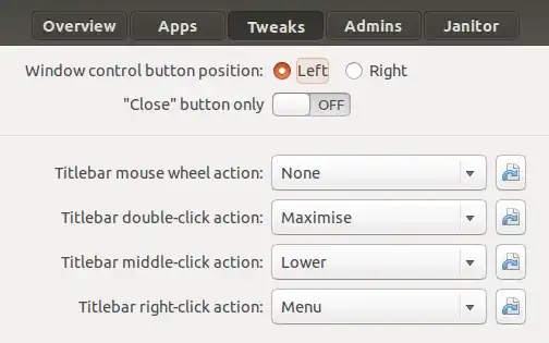

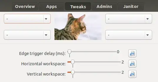

Window tweaks
  1. Window control button position - display the window close/minimize/maximize buttons on the left or right side of the window
  2. "Close" button only - only show a close button
  3. titlebar actions - what happens when performing various mouse actions on the title-bar
Workspace settings
  1. Edge trigger delay (ms) - delay in milliseconds before window is pushed into the next workspace
  2. Horizontal workspace - number of horizontally displayed workspaces
  3. Vertical workspace - number of vertically displayed workspaced

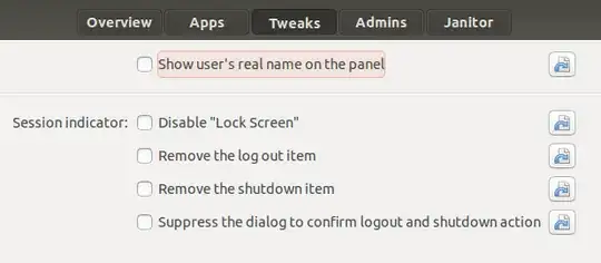

Various tweaks as shown in the image to control the session indicator
  4. Pressure Decay Rate - the rate at which the mouse pressure decays
  5. Edge Stop Velocity - the maximum velocity at which the mouse will still be stopped
  6. Duration of Sticky Edge Release after Break - delay after the sticky edge barrier is broken
  7. Hide Animation - launcher animation
  9. Enable Shortcut Hints Overlay - pressing and holding the Super key displays the keyboard shortcuts overlay. This can be disabled through this setting.
  10. Menus Fade-in duration - duration (in milliseconds) that the global menu fade-in animation takes to display when the mouse moves into the global menu region.
  11. Menus Fade-out duration - duration (in milliseconds) that the global menu fade-out animation to display when the mouse moves into the global menu region.
  12. Menus discovery duration - number of seconds the global menu should display when an application is first started
  13. Menus discovery fade-in duration - duration (in milliseconds) that the fade-in animation takes when the global menu is displayed for an launched application
  14. Menus discovery fade-out duration - duration (in milliseconds) that the fade-out animation takes when the global menu is displayed for an launched application
  15. Launcher Monitors - controls whether launcher should be displayed on multiple desktops
  16. Launcher Capture Mouse - determines if the launcher edges should capture the mouse

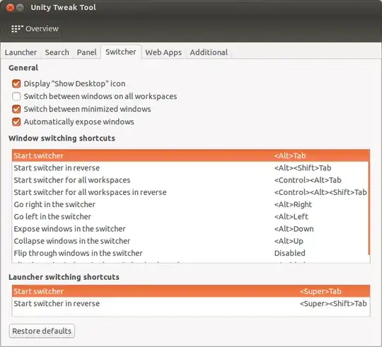

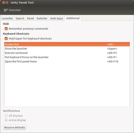

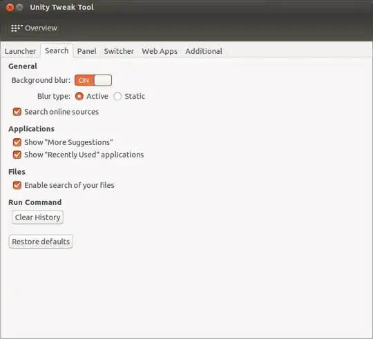

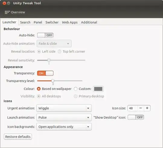

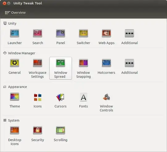

Unity Tweak Tool can be used to configure Unity in Ubuntu 13.04 and later. It is also available in a PPA for 12.10 Ubuntu users.
installation
unity-tweak-tool Install unity-tweak-tool
or via the command sudo apt-get install unity-tweak-tool
For installation on 12.10 you'll have to add the Unity Tweak Tool (UTT) from a PPA. Run
sudo add-apt-repository ppa:freyja-dev/unity-tweak-tool-daily
To add the PPA, and
sudo apt-get update && sudo apt-get install unity-tweak-tool
To update the package list and install UTT.
Configuring Unity
As you can see UTT has quite a lot of options when it comes to configuring your desktop.
The main interface is divided into four main categories:
  • Unity
  • Window Manager
  • Appearance
  • System
note: There is a restore defaults button on every tab that will restore all settings to their default values for that tab.
Unity
The Unity section contains most of the Unity centric configuration options that Unity Tweak Tool offers.
Launcher
From the Launcher tab you can configure the elements of the Unity Launcher:
behaviour
  1. Auto-hide: Sets whether the launcher auto-hides when not in focus
  2. Auto-hide animation: Controls the animation used in auto-hiding the launcher if auto-hide is set to on.
  3. Reveal location: If auto-hide is activated, controls whether you can activate the launcher from the sides or only in the top left corner.
  4. Reveal sensitivity: If auto-hide is activated, controls the sensitivity of the launcher when giving it focus.
appearance
  1. Transparency: Controls whether the Launcher is transparent.
  2. Transparency level: If transparency is activated, controls the level of launcher transparency.
  3. Colour: Controls whether the color of the launcher is based on the current wallpaper or uses a custom color.
  4. Visibility: If multiple monitors are in use, controls whether the launcher is visible on all desktops or just the primary desktop.
icons
  1. Urgent animation: Controls the urgent animation of launcher icons.
  2. Launch animation: Controls the animation of a launcher icon when the application is being launched.
  3. Icon backgrounds: Controls when the icon backgrounds (called "backlight") is on.
  4. Icon size: Controls the size of launcher icons.
  5. "Show Desktop" icon: Controls whether the "Show Desktop" icon is visible in the launcher.
search
From the search tab you can configure Unity's search.
general
  1. Background blur: Controls whether the background of the dash is blurred or not.
  2. blur type: If background blur is enabled, controls whether the blur updates with the background or not.
  3. search online sources: Controls whether the launcher shows results from online sources.
applications
  1. Show "More Suggestions": Controls whether the "More Suggestions" category is displayed in dash results.
  2. Show "Recently Used" applications: Controls whether the applications lens shows your recently used applications.
files
  1. Enable search of your files: Enables or disables the ability to search unlogged files from the files lens.
run command
  1. Clear history: Clears your Alt+F2 command history.

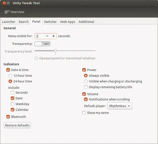

panel
The panel tab controls the settings of Unity's panel.
general
  1. Menu visible for: Sets how long an application's menu is visible when it is first opened.
  2. Transparency: Enables or disables panel transparency.
  3. Transparency level: If transparency is enabled, controls the level of transparency.
  4. Opaque panel for maximized windows: If transparency is enabled, controls whether maximized panel of windows is transparent as well.
indicators
The indicators sections contains settings for fine tuning the indicators in Unity's panel.
Some of the things you can control include:
  • Fine tune the amount of detail the time and date indicator has, (date, 24 hour time, seconds etc)
  • Enable or disable the bluetooth indicator
  • Fine tune the power indicator
  • Enable or disable the volume indicator and change the default music player
  • Show your username in the panel
switcher
The switcher tab allows you to configure Unity's Alt+Tab switcher.
general
  1. Display "Show Desktop" icon Sets whether the "Display Desktop" icon is displayed in the switcher.
  2. Switch between windows on all workspaces: Controls whether the switcher shows applications on all workspaces or just the current workspace.
  3. Switch between minimized windows: Controls whether the switcher allows you to switch to minimized windows.
  4. Automatically expose windows: Controls whether the switcher exposes minimized windows.
Window switching shortcuts and Launcher switching shortcuts allow you to customize the keys used in the various switcher actions.
web apps
The web apps tab lets you customize several web app features, including prompts on supported sites.
  1. Integration prompts: Controls whether you get an installation prompt when visiting a site with a supported web app.
Additional
HUD
  1. Remember previous commands: Sets whether the HUD remembers previous commands you've used.
Keyboard Shortcuts
  1. Hold Super for keyboard shortcuts: When activated, pressing Super will highlight the various Unity shortcuts.
You can also change a few of Unity's launcher keyboard shortcuts.
Notifications
Here you can set whether (in a multiply monitor display setup) notifications are displayed on the active display or all displays.
Unity Tweak Tool can do a lot more as well, and I hope to cover everything it can do eventually.

Aside from the CCSM (Compiz Config Settings Manager) configurations described in another reply to this thread, you can also change what menu options appear when you right-click on an application launcher (icon) in Unity through custom launchers and so-called quicklists.
For example, you can add STOP, PLAY, PAUSE, NEXT, PREVIOUS to your Banshee icons, you can add your favorite folders to your Nautilus (file browser) icon, you can add common SSH servers to your terminal icon, etc.
To find examples and instructions of said quicklists, see another popular question: What Custom Launchers and Unity Quicklists are available?.

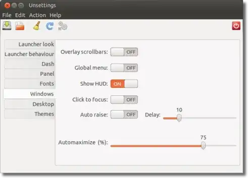

Unsettings
screenshot of Unsettings
Unsettings is a graphical configuration program for the Unity desktop environment that lets you change some of the Unity settings.
Unsettings can only change your users’s settings, you can’t use it to change global settings or do anything else that needs root privileges.
You can use Unsettings to change the themes for GTK, window manger, icons and cursors. But it doesn’t support the installation of new themes.
With Unsettings you can switch off the global menu and the overlay scrollbars used in Unity.
In addition to just applying the settings Unsettings lets you to save your settings into and load from a text file (JSON format) so you can easily backup you settings or copy them to a different account.
Unsettings is available for Ubuntu 11.10 and later.
