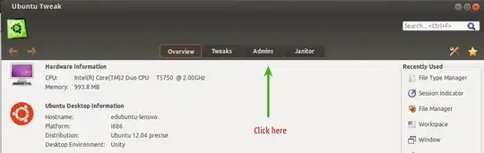

  2. Then open it by typing "Ubuntu-tweak" on the dash
    Opening ubuntu tweak from dash
  3. After opening Ubuntu-tweak, go to the Admin tab
    Select Admin

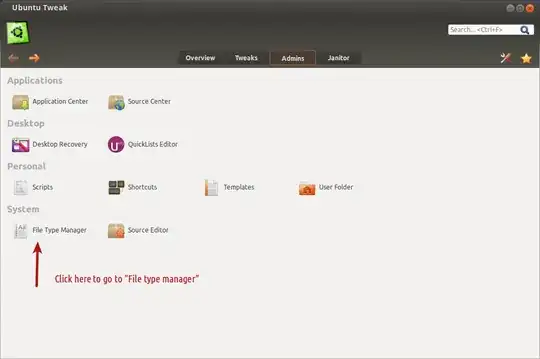

  4. Then Go to the File type manager option
    file type manager

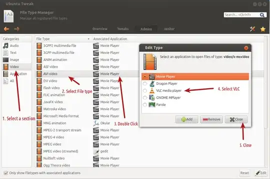

  5. In this section, do these:
    1. Select a catagory of media types, such Audio or Video
    2. Select a type of the file, such as mp3, mkv etc
    3. Double click the currently associated application such as Totem or something
    4. In the new opened small window, Select VLC media player and close it.
      changing default apps
  6. Then close the Ubuntu-tweak and see the changes by doing a Right-Click.

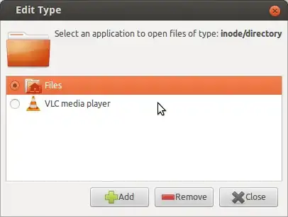

Instruction for Directory: After subsequent comment by the OP, I realized that, he wanted to enable an entry in the directory with "Open with VLC media player". (And OP done this, before I edit the answer. ;P).
To do so, Follow the steps from 1-5. In the step 5, the procedures are slightly changed. These are:
  1. Select the catagory All
  2. Select the file type Folder
  3. Double Click it to bring a new window. In this window, do these:
    1. Remove all entries except Files from there by selecting one and then pressing Remove button.
    2. After removing all except Files entries, Press Add button and Select the VLC media player from the new window and pressing Add button there. Remember to select the Files entry as default before closing this window.
      The final file type choosing window should look like this
      Files and VLC only
      Note that, in the image, Files entry is selected to be the default.
    3. Close all windows and close the Ubuntu tweak.
That's it.
