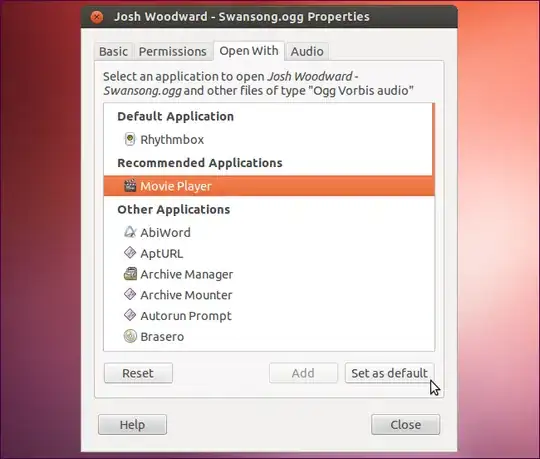

Seems like the answer here
is actually the easiest, specifically going to a file's properties, going to the "open with" tab, and then setting as default for that file type. Here's the picture:

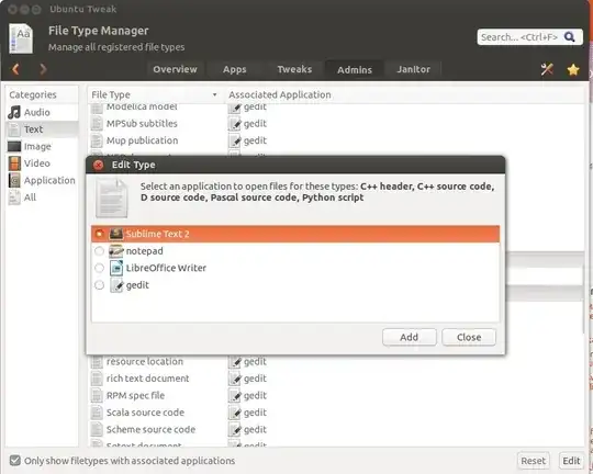

The EASIEST way for you to do this would be to install the program Ubuntu Tweak.
Once you have it downloaded you simply open it up, change to Admins tab and then under System choose File Type Manager. Once in here select the file category Text and using shift-click and/or control-click select all of the file types you want, then click Edit on the bottom right.
This will allow you to multi-set the mimetype opener for all of the files.
See screen:
https://i.sstatic.net/BZtGN.jpg

I guess the easiest graphical way would be:
Files (nautilus) >> select a file >> right click & Properties >> "Open With" tab >> select a program you fancy >> "Select as default". Done.
This method comes from this post on HowToGeek: http://www.howtogeek.com/117709/how-to-change-your-default-applications-on-ubuntu-4-ways/ where they also talk about how to change default Terminal programs.

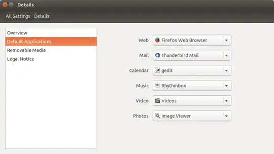

Go to Details from Unity Dash, click on Default Applications on the left pane. Change the file associations as per your preference. No additional installation required and you can set all your default applications from one place.
