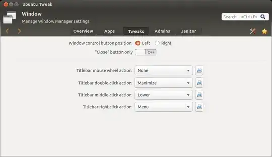

Open Ubuntu Tweak, go to the Tweaks tab and click on Window. Then set the window control button position to be right.
Ubuntu Tweak
