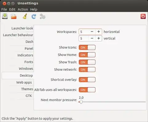

You can enable them using Unsettings:
Unsettings "Desktop" tab
Or you can use the command line:
gsettings set org.gnome.nautilus.desktop home-icon-visible true
gsettings set org.gnome.nautilus.desktop computer-icon-visible true
gsettings set org.gnome.nautilus.desktop trash-icon-visible true
gsettings set org.gnome.nautilus.desktop network-icon-visible true

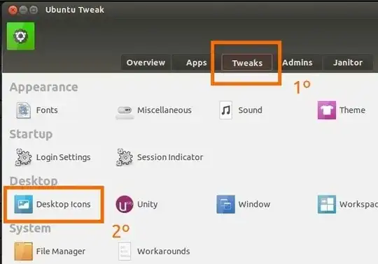

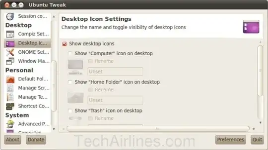

The answer
  1. Install Ubuntu Tweak Install-It
  2. Click in the Tweaks label and then in the Desktop Icons icon (sounds recursive :) )
    SS_1
  3. Finally you should see a window similar than the following allowing you to show/hide the icons.
    SS_2
This is my result. It works even when donf have different values.

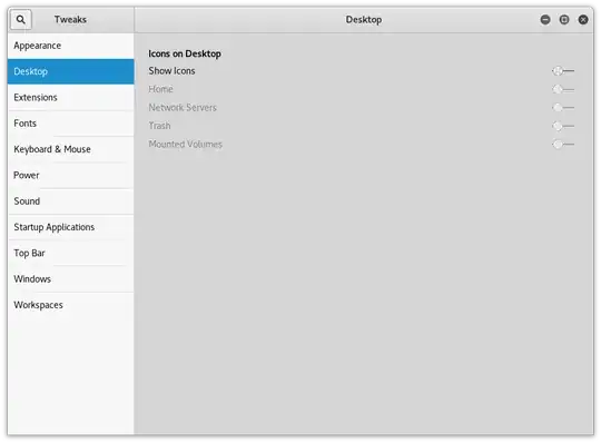

Install the Tweaks with sudo apt install gnome-tweaks
Then, open Tweaks and go to the desktop tab and uncheck whatever you do not want on your desktop.
Gnome Tweak Tool
