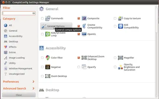

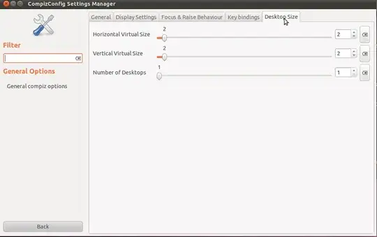

On later versions of Ubuntu Workspaces are in the Workspace switcher. The number of desktops can be modified by installing the CompizConfig Settings Manager and changing the numbers listed under "General Options > Desktop Size".

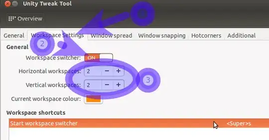

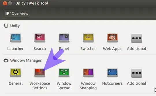

Workspaces are by default disabled on a new install of Ubuntu v13.04.
You can toggle workspaces on/off as well as defining the number of workspaces through unity-tweak-tool Install unity-tweak-tool (sudo apt install unity-tweak-tool)

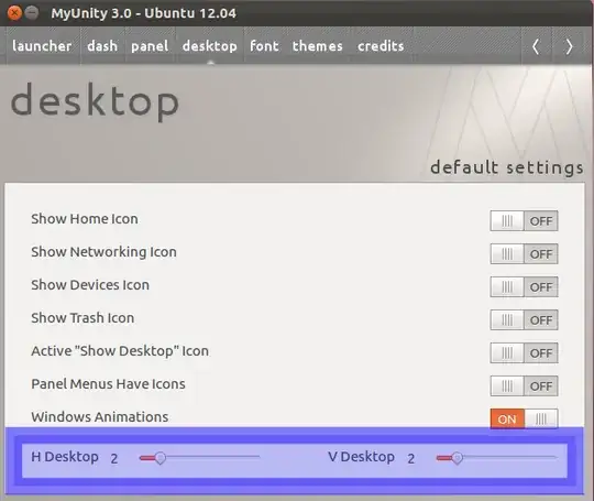

12.04 install
The number of workspaces can be safely set without using CCSM through MyUnity
Move the slide-bars to change the number of horizontal & vertical workspaces
for example 4x1

Using CCSM
This works on Ubuntu 12.04 LTS as well, but it is easier and safer to use MyUnity instead.
Warning: ccsm can lead to unwanted effects that may be hard to overcome and may leave you without a desktop (see also this question for more background information).
The options for the number of workspaces can be found in compizconfig-settings-manager install ccsm under General Options. Do not set horizontal workspaces below 2 or the workspace switcher button won't work.

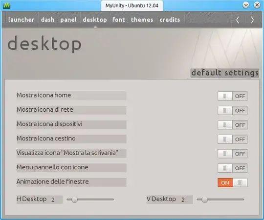

Using MyUnity
MyUnity can be used also in 11.10 and below, with additional steps.
In a terminal, use sudo add-apt-repository ppa:myunity/ppa && sudo apt-get update && sudo apt-get install myunity to install MyUnity. Then, use the steps described above to 12.04.

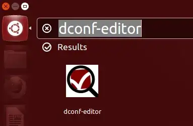

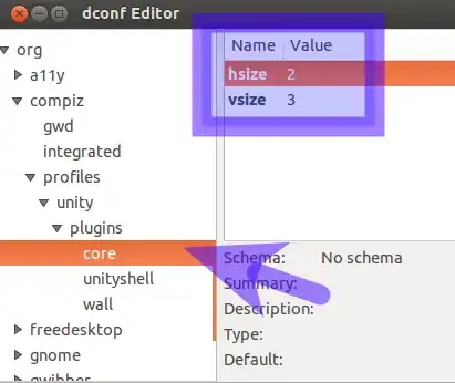

dconf-tools Install dconf-tools
IMPORTANT NOTE: you must have used method one or two previously for dconf-editor to show the keys to change.
The reason for this is because dconf-editor does not show relocatable schema keys by default unless they have been previously changed.
First install dconf-tools.
Then press ALT+F2 and type dconf-editor
Press Enter or click on the icon shown.
This then opens the application:
Navigate down the tree to org - compiz - profiles - unity - plugins - core and change the values shown.

Install compizconfig-settings-manager, launch it through System Settings (in the Personal section), then go to General Options (in the General Section), now in the tab Desktop Size you can change the number of vertical or horizontal desktops.

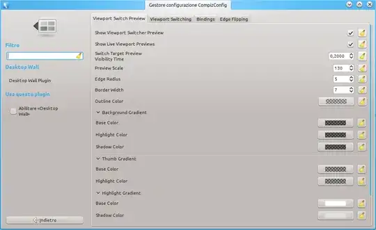

ccsm (CompizConfig Settings Manager) ccsm
Open a terminal and run:
gksudo apt-get install ccsm
enter your password and enter y when asked.
Now press ALT and F2 together, type ccsm and press Enter.
When CompizConfig Settings Manager appears, select Desktop Wall.
MyUnity myunity With MyUnity you can set the number of desktops, but nothing more.
gksudo apt-get install myunity
Now press ALT and F2 together, type myunity and press Enter.
When MyUnity appears, select desktop. Change H Desktop for horizontal desktops and V Desktop for vertical desktops.

I used CompizConfig Settings Manager (CCSM). Open CCSM, select General Options then go to the Desktop Size tab.
You can adjust the number and the layout of the workspaces by using the Horizontal Virtual Size and Vertical Virtual Size sliders to adjust the number of "columns" and "rows" respectively.
Using this method does not appear to change the settings mentioned above in gconf editor.
