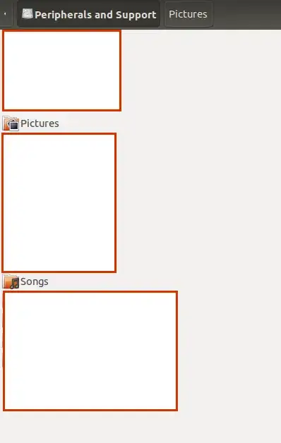

One of the possible ways is using Ubuntu tweak.

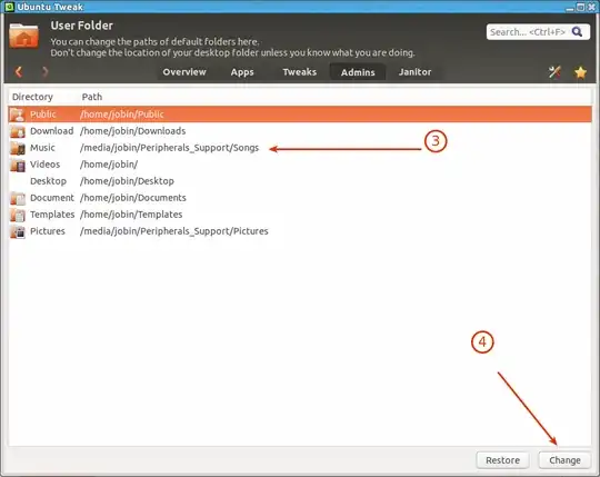

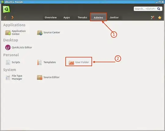

  • Open ubuntu tweak and go to Admins > User folder and then click on the folder you want to change. Click on "Change" and browse to the folder which you want to mount on.
ubuntu tweak -admin and user folder
change folder mount
