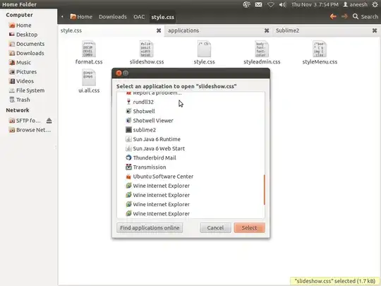

There is a workaround for this issue. as an example i am adding sublime(an ide) to the list.
1). Open a terminal and run this command:
 cp /usr/share/applications/gedit.desktop ~/.local/share/applications/sublime.desktop
2). Edit the new file and make necessary changes
vim ~/.local/share/applications/sublime.desktop
[Desktop Entry]
Name=sublime2
GenericName=Sublime2 - IDE
Comment=Edit text files
Exec=/home/aneesh/Sublime2/sublime_text %U
Terminal=false
Type=Application
StartupNotify=true
MimeType=text/plain;
Icon=/home/aneesh/Sublime2/sublime.jpeg
Categories=GNOME;GTK;Utility;TextEditor;
X-GNOME-DocPath=gedit/gedit.xml
X-GNOME-FullName=Sublime2
X-GNOME-Bugzilla-Bugzilla=GNOME
X-GNOME-Bugzilla-Product=gedit
X-GNOME-Bugzilla-Component=general
X-GNOME-Bugzilla-Version=3.2.0
X-GNOME-Bugzilla-ExtraInfoScript=/usr/share/gedit/gedit-bugreport
X-Ubuntu-Gettext-Domain=gedit
Please note that you might end up with duplicate launchers in your dash with this method. To prevent this you can add NoDisplay=true to your newly created launcher.
Save the file . That's it, done.

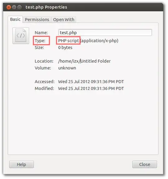

  • Open Nautilus, find one of the files we want (here, .php), right-click on it and click on Properties:
  • In the Properties window which comes up, note the text shown just after Type:; that's the MIME description we're looking for (here, "PHP Script"):

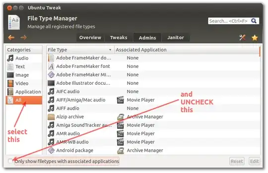

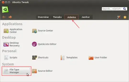

  • Start Ubuntu Tweak from the Dash, and click on the Admins tab on top; then click on the File Type Manager entry on the bottom:
  • After the File Type Manager opens, click on All in the left sidebar, and uncheck the Only show filetypes... box at the bottom:

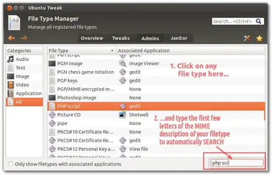

  • Select any filetype on the right side, and begin typing the first few letters of the MIME description from Step 2 to automatically search and select your filetype:

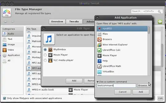

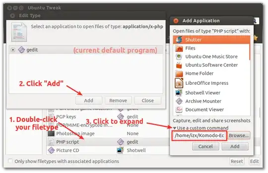

    • Click on Add, and in the Add Application window, expand the Custom Command option on the bottom
    • Type the command/program you want or use the Browse button to navigate to it and select it; here we have selected the Komodo-Edit editor from my home folder:

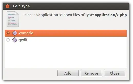

    • Click on Add, so the new command is now the default, and then click Close:

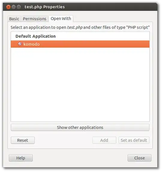

  • PHP files will now open in Komodo by default, as seen in the Properties below; press the Reset button to go back to the default for that filetype:
