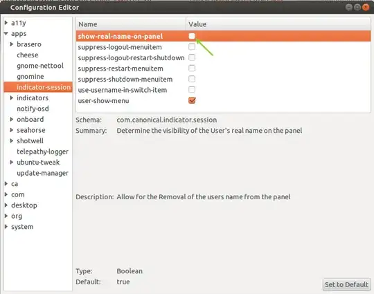

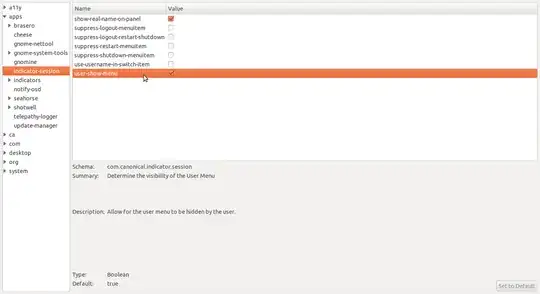

12
open dconf-editor, go to "apps -> indicator-session" and unmark "user-show-menu"
logout and login again

xsquirrel
  • 121
Install package dconf-tools
sudo apt-get install dconf-tools
press Alt+F2 and run:
dconf-editor
In dconf-editor, navigate to apps > indicator-session and untick the option show-real-name-on-panel
Then reload unity to see the effect:
unity --replace
Or logout and login

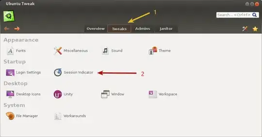

2) Graphical way (using Ubuntu-tweak)
  1. Install Ubuntu-tweak
  2. Open Ubuntu-tweak by typing the name in dash
    opening ubuntu-tweak from dash

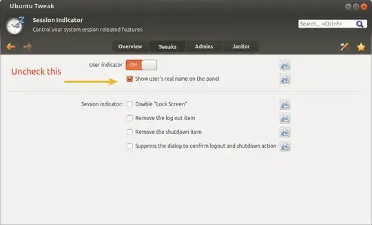

  3. Go to the section TweaksSession indicator
    Go to Tweaks -> Session indicator
  4. Toogle the switch User indicator to Off state.
(To revert the settings, just toogle the User indicator switch again)
That's it. Logout and Login again to see the change.
Below are screenshots before and after disabling the user name:
  • Before:
  • After:
