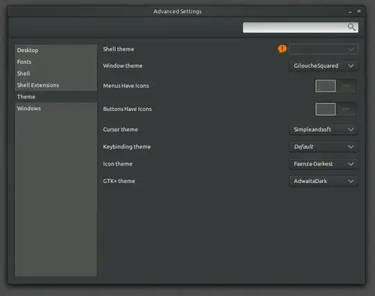

  • Integrating some, but not all applications (that use the current theme as shown in the screen shot) to my standard and preferred dark GTK theme.

Edit: I already use gnome-tweak-tool, gconf & dconf editor, to customize and setup themes, fonts, icons etc. but in this case to no avail. I also know, where themes and icons are located on my system, but I can't figure it out for the theme in question. It is no Qt3/Qt4 Theme either!

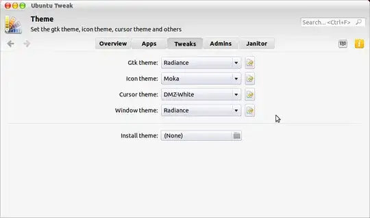

You can try Ubuntu Tweak, which gives easy interface to tweak desktop and system configuration available under utils section in Precise.
snap1

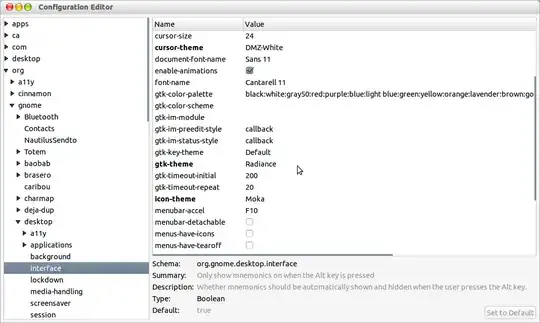

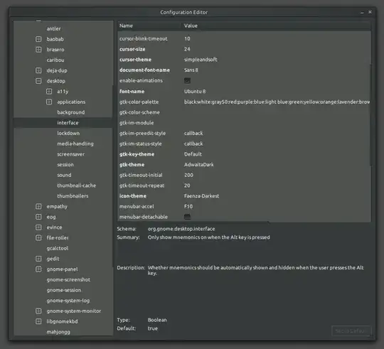

Or you could use Dconf editor (install with sudo apt-get install dconf-tools). In Precise it's available under universe/libs section.
snap2
