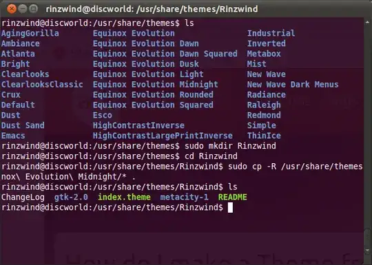

  • Open terminal and cd /usr/share/themes/
  • sudo mkdir Rinzwind
  • cd Rinzwind
  • sudo cp -R /usr/share/themes/Equinox\ Evolution\ Midnight/* .

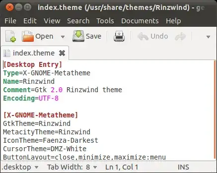

Inside the new directory is a file named index.theme that needs to be changed to the new theme name. So after entering sudo gedit index.theme change all the old theme names to the new one:
im2
String, search and replace Equinox Evolution Midnight -> Rinzwind

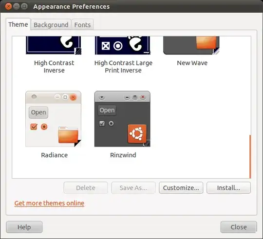

And now we have a new name for an old theme:
im2

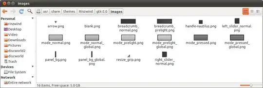

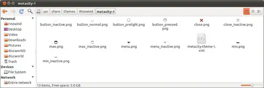

Inside our new directory are 2 sets of images:
im5
im6
With an image editor (Gimp) you can change the colors or do various things on the images. Make sure to keep the same size of the image and of course use sane colors (stick to one color and 1 or 2 shades of this color to make a theme and not something that gives people instant headaches).

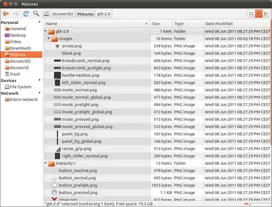

Recreate these 2 directories in your Pictures folder by copying the theme to your Pictures. I copied the 2 directories inside the theme and removed all directories that are not images with this as a result:
im7

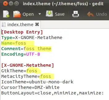

Inside the new folder is a file named index.theme that needs to be changed to the new theme name.
gedit ~/.themes/foss/index.theme change all the old theme names to the new one.
And now we have a new name called foss:

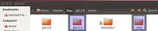

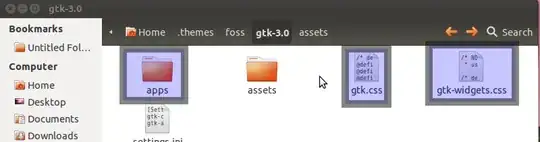

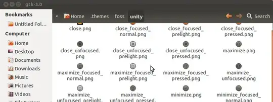

Inside our new directory are two key folders - Unity and gtk-3.0:
With an image editor such as Pinta or Gimp you can change the colours or do various things on the images within those folders.
Make sure to keep the same size of the image and of course use sane colors (stick to one color and 1 or 2 shades of this color to make a theme).
Open all the images inside Pinta/Gimp and start editing them and when you are satisfied copy them over with to your theme's directory.
However - the main part of theme editing is changing the various .css files in those folders (and the subfolder Apps).

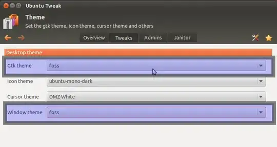

Once you are happy with your theme - set your theme via Ubuntu-Tweak
Unfortunately you cannot change themes via the standard Appearance screen - the themes there are hard-coded in 11.10 & 12.04.
