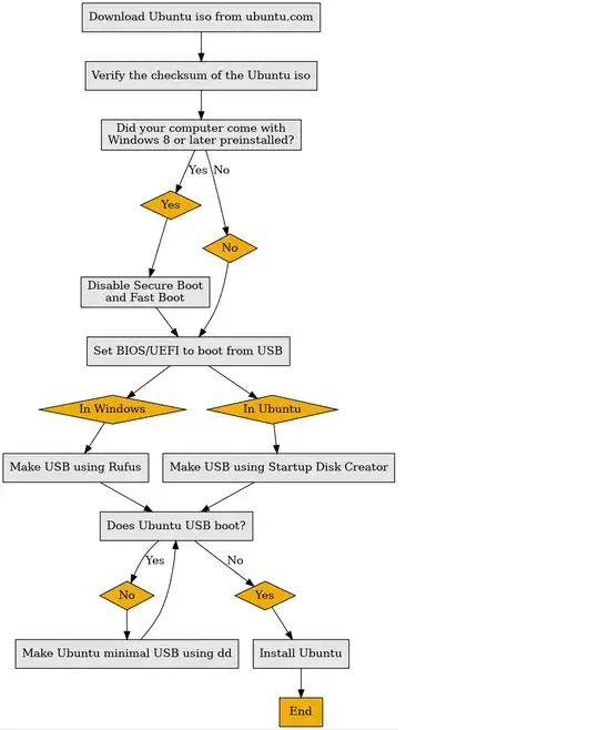

This flowchart shows how to make a bootable USB for installing Ubuntu and troubleshoot problems booting Ubuntu from it.

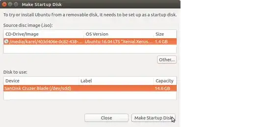

How to make an Ubuntu USB on Ubuntu using Startup Disk Creator
Ubuntu has a built-in application for creating a bootable Ubuntu live USB for installing Ubuntu called Startup Disk Creator. Search the Dash for Startup Disk Creator and click the Startup Disk Creator icon to open the Make Startup Disk window.
The USB flash drive that you use with Startup Disk Creator should be 2GB or larger, and for Ubuntu 18.04 and later it should be 4GB or larger. Startup Disk Creator will automatically format your USB flash drive to FAT32 and make it bootable. If you have only one USB flash drive plugged in to your computer, Startup Disk Creator will select it automatically. Be very careful to select the USB flash drive in the Make Startup Disk window in order to avoid overwriting the partition which Ubuntu is installed on, which may make Ubuntu unbootable. In the screenshot below you can see how the USB flash drive Device is identified by its model name, the same model name that appears under the Drive heading after Model: in the Disks (disk utility) application.
Startup Disk Creator in Ubuntu 16.04

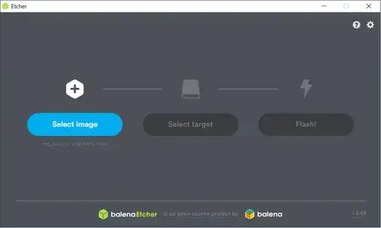

balenaEtcher - v1.5.63 (BIOS and UEFI, No persistence out of the box but creates casper-rw partition, (19,10 & later), easy to change to NTFS data space. Similar to SDC)
balenaEtcher

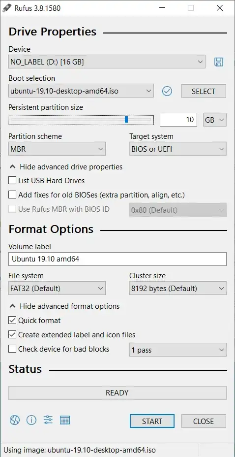

Rufus - 3.8 (BIOS and UEFI Unlimited persistence Ubuntu 19.10 and later)
Rufus
