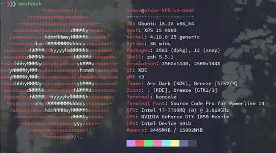

Atm, my Ubuntu 18.10 distribution is burning. I can not install any packages as I wrecked the apt part, and many programs are either broken or not installed correctly. Thus, I figured the easiest solution would do a clean install of Ubuntu 20.10. Here is a screenshot with more details
As I do not have an LTS version directly upgrading did not work, I tried a few hacks to make it work, and it was probably this that broke my apt. After some work, I was able to create a bootable USB stick with the 20.10 LTS ISO of Ubuntu. I did it as follows
