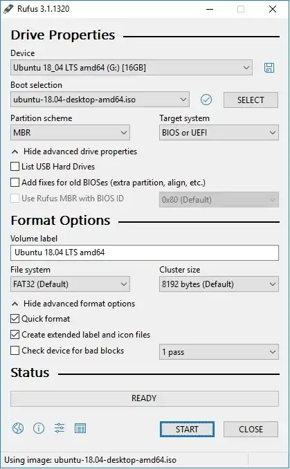

Rufus
Rufus - 3.1.1320 (BIOS and UEFI)

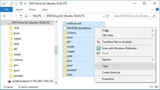

Copy/Paste ISO Contents
Copy/Paste ISO Contents - (UEFI only)

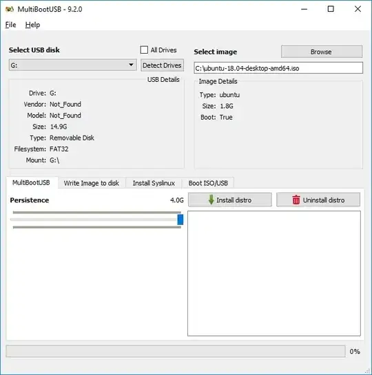

MultiBootUSB
MultiBootUSB - 9.2.0 (BIOS and UEFI, 4GB persistence, Problems: Missing casper-rw file)

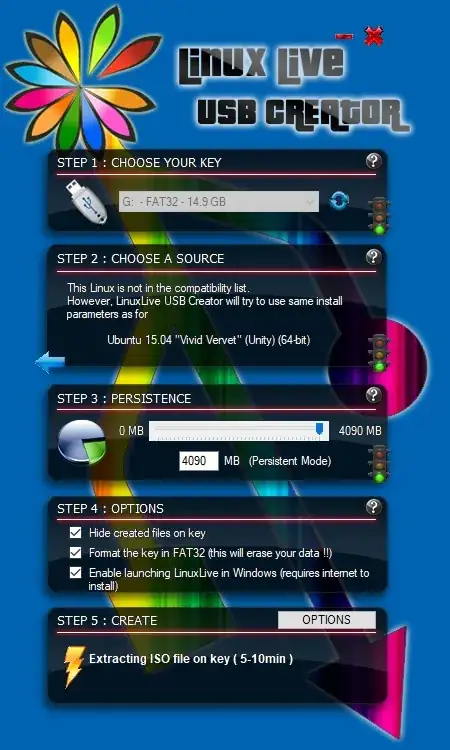

Linux Live
Linux Live - 2.9.4 (BIOS and UEFI, >4GB persistence BIOS only, comes with Portable Virtualbox)

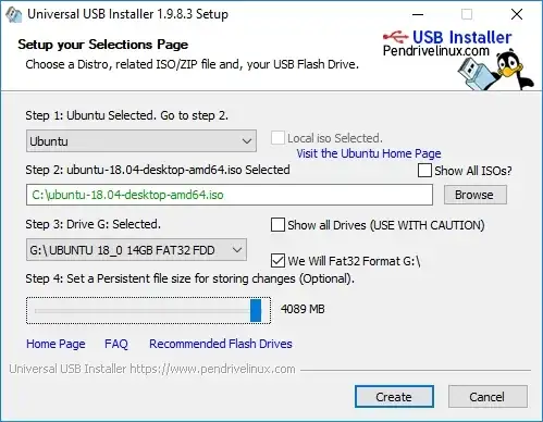

Universal - 1.9.8.3 (BIOS and UEFI, 4GB persistence)(>4GB BIOS/NTFS)

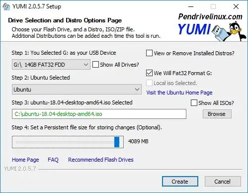

YUMI
YUMI - 2.0.5.7 (BIOS only, >4GB persistence NTFS)
YUMI-UEFI - 0.0.0.8 (UEFI only, 4GB persistence)
