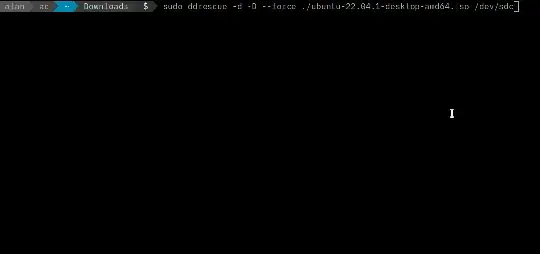

I personally prefer ddrescue via the gddrescue deb in the repository. It provides a decent output of progress. It is possible to bodge dd (via tools like pv) into giving some progress output. But ddrescue output is just better, in my humble opinion. Here:
$ sudo ddrescue -d -D --force ./ubuntu-22.04.1-desktop-amd64.iso /dev/sdc
