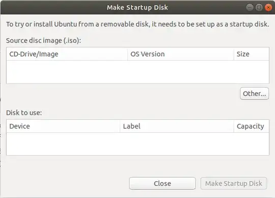

you can use Startup Disk Creator. If you don't have it installed, you can install it via Ubuntu Software.
After you run it, you have to choose the path to you iso file and select the disk to use (the USB Drive). Then press the button Make Startup Disk.
