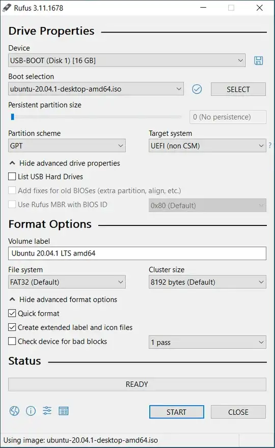

Assuming you want to boot 20.04 in UEFI mode and that there are no other OS on the computer
  • Start with Rufus set up as shown below.

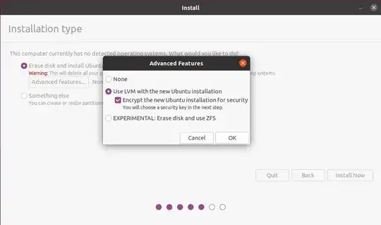

  • Proceed with install Ubuntu until you get to Installation Type.
  • If you want a typical setup select Erase disk and install Ubuntu and then select Install Now.
  • If you want an encrypted installation, select the options shown below and then select Install Now:
  • Proceed with installation until complete.
