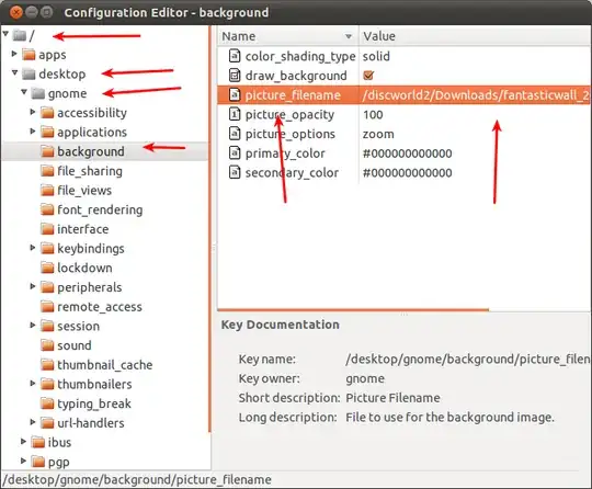

  • Changing settings inside gconf-editor.
    You can change any gconf option if you know what the path is of that option and the value you want it to be (and the type of the value of course).
    Changing the wallpaper is done with the path I pointed arrows to: /desktop/gnome/background/, it is a string value and it uses picture_filename as an option. The value it currently holds on my desktop is /discworld2/Downloads/fantasticwall_2.jpg. The background itself should be copied into /usr/share/backgrounds/. Make sure to set permissions and owner.
    Examples:
    • To change the wallpaper (change the filename in the 1st command to your own image) to this image and to change the theme to Radiance you can use this information to create commands to set this for your live cd:
      gconftool-2 --direct --config-source xml:readwrite:/etc/gconf/gconf.xml.defaults --set -t string /desktop/gnome/background/picture_filename  /discworld2/Downloads/fantasticwall_2.jpg
      gconftool-2 --direct --config-source xml:readwrite:/etc/gconf/gconf.xml.defaults --set -t string /desktop/gnome/interface/gtk_theme Radiance
      Courtesy of dv3500ea

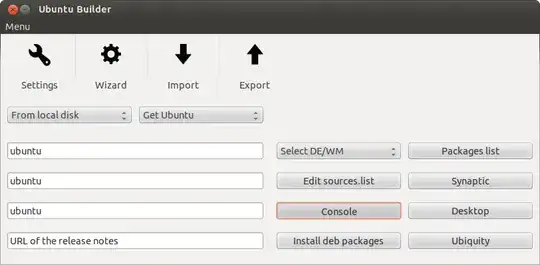

##Creating a custom 12.04 CD with Gnome-Classic using Ubuntu-Builder (for now, this is specific to Karthik's needs; I will update answer later with more general/Unity-specific stuff)
###1. Get Ubuntu Builder and your source ISO
Ubuntu Builder automates many of the preliminary steps that had to be done by hand (mount ISO, extract squashfs, create chroot, etc.) It gives you Synaptic and a "graphical" chroot as well (Unity UI).
Add the PPA to install Ubuntu Builder:
sudo add-apt-repository ppa:kamilion/ubuntu-builder
sudo apt-get update
sudo apt-get install ubuntu-builder
Also download the Ubuntu Desktop ISO you're planning to work with.
###2. Ubuntu Builder Basics
  • Start Ubuntu Builder from the Launcher. I recommend you set all three fields to "Ubuntu" (like the actual LiveCD), because setting custom fields led to Software Center crashing. When you install, you can choose your own username, machine name, etc. as always.
  • Load your ISO; I loaded the 64-bit with the Local Disk option, although Ubuntu Builder should be able to download the ISO if you want it to.
  • The buttons on the right are self-explanatory. Console gives you a CLI chroot, while Desktop gives you a graphical one!, i.e. a LiveCD session itself (this one may take a while to load). Note that the Select DE/WM does an incomplete job sometimes, so it's better to install via apt-get/Synaptic.

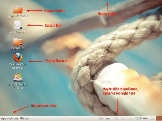

###4. Customization 1: Files, configs and removing the top-panel
Note: All commands must be run from the chrooted console of Ubuntu Builder unless otherwise noted (usually when copying files from your own system). The absolute path of the chroot is /home/ubuntu-builder/FileSystem
  1. Replace Samba configuration file (from your own system terminal, i.e. outside chroot!)
sudo cp /path/to/mysmb.conf /home/ubuntu-builder/FileSystem/etc/samba/smb.conf

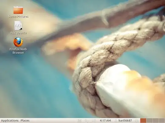

  1. Put Firefox shortcut on desktop:
mkdir -p /etc/skel/Desktop && cd /etc/skel/Desktop
cp /usr/share/applications/firefox.desktop .
chmod +x firefox.desktop
  1. Copy custom shortcuts and folders to Desktop (from outside chroot!)
    sudo cp -r /path/to/mydesktopitems/ /home/ubuntu-builder/FileSystem/etc/skel/Desktop/
  2. Set gnome-classic as the default shell:
/usr/lib/lightdm/lightdm-set-defaults -s gnome-classic
  1. Remove the top Gnome-Classic panel and move top-items to the bottom-panel:
  • Open the default panel layout:
    nano /usr/share/gnome-panel/panel-default-layout.layout
  • Delete the top-panel, by removing lines 1-4:
    [Toplevel top-panel]
expand=true orientation=top size=24
  • Move the Start Menu to the bottom left by modifying the bolded value for the italicized parameter as below:
[Object menu-bar] object-iid=PanelInternalFactory::MenuBar toplevel-id=bottom-panel pack-index=0
  • Move the indicators to the bottom right, just to the left of the Workspace Switcher, by modifying the bolded value for the italicized parameters as below:
[Object indicators] object-iid=IndicatorAppletCompleteFactory::IndicatorAppletComplete toplevel-id=bottom-panel pack-type=end pack-index=1
  • Remove the "Show Desktop" button from the bottom left; I prefer the Start Menu to be the first thing there, you can leave it or move it to the bottom right, etc. Delete these lines:
[Object show-desktop] object-iid=WnckletFactory::ShowDesktopApplet toplevel-id=bottom-panel pack-index=0
  • Save and exit.

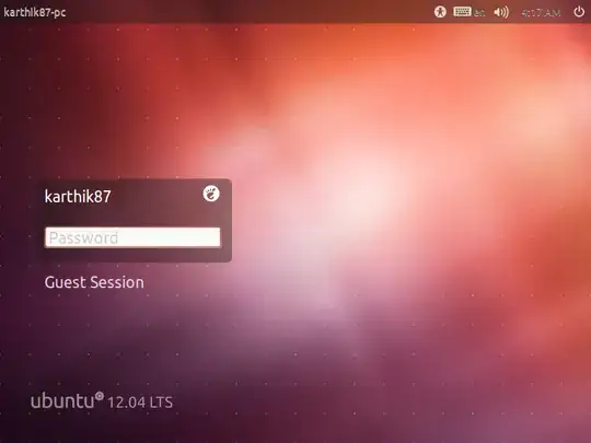

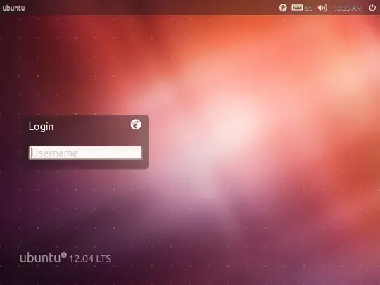

  1. Disable the login screen (lightdm) from "copying" the desktop background and other changes:
  • Open nano /usr/share/glib-2.0/schemas/com.canonical.unity-greeter.gschema.xml
  • You can change the login background from the default here if you want:
<key name="background" type="s"> <default>'/usr/share/backgrounds/warty-final-ubuntu.png'</default>
  • Disable "copying" the desktop background by setting this to false:
     <key name="draw-user-backgrounds" type="b">
      <default>false</default>
- Set the login theme to Radiance:
          <key name="theme-name" type="s">
      <default>'Radiance'</default>
  1. Change the default wallpaper; here, we'll set it to the included "Tie My Boat" (/usr/share/backgrounds/Tie_My_Boat_by_Ray_GarcĂ­a.jpg):
  • Open nano /usr/share/glib-2.0/schemas/10_gsettings-desktop-schemas.gschema.override, and change the below line to the path for your file:
picture-uri='file:///usr/share/backgrounds/warty-final-ubuntu.png'
  1. Change the theme to Radiance
  • Open Ubuntu's theme override file ``nano /usr/share/glib-2.0/schemas/ubuntu-artwork.gschema.override`, and change the Ambiance below to Radiance:
[org.gnome.desktop.interface] gtk-theme="Ambiance" ... [org.gnome.desktop.wm.preferences] theme="Ambiance"

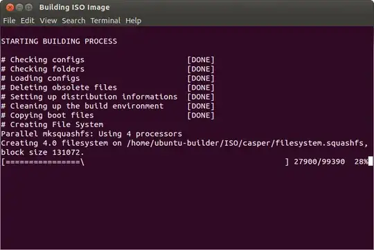

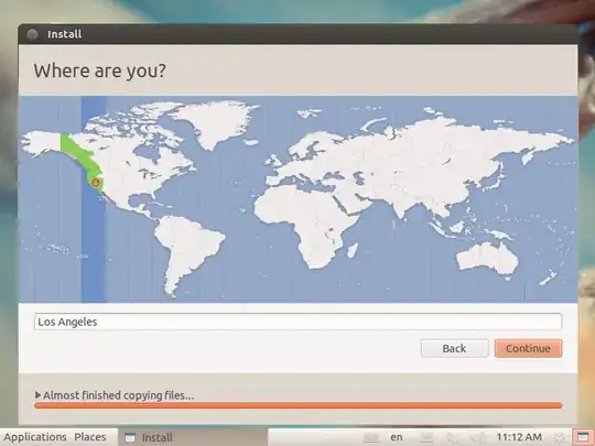

###6. Build, test and install!
  • Press the Build button in Ubuntu Builder to begin building the custom Live-CD ISO. UB automatically handles the cleanup, etc. that previously had to be done manually.
  • The ISO can be found in /home/ubuntu-builder; you can test it using the built-in QEMU, or in another virtual machine.
  • My finished CD size was 778 MB (after removing the old .23 kernel), with Unity and Gnome 3D still available if the user wishes to, so that's pretty good for a customization! :)

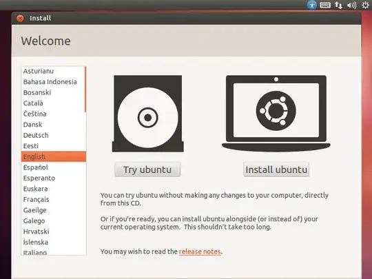

  1. After bootup, you get the "Try Ubuntu" or "Install Ubuntu" option:
  1. Clicking "Try" gets us our custom desktop!
  1. And logging out (login with ubuntu, blank password) shows that the login wallpaper is kept at the default:
  1. Installer does not crash upon Timezone selection:

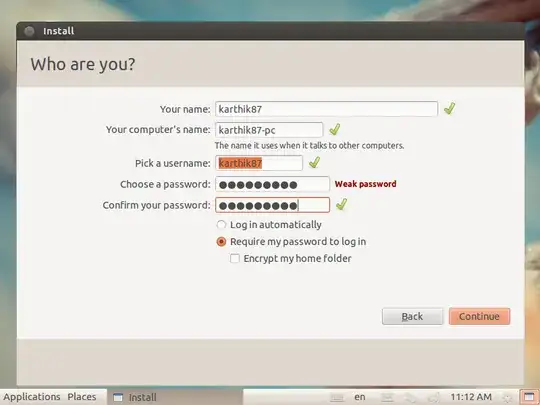

  1. Select username, etc. for install:
  1. Installed login screen:
  1. Installed desktop:
