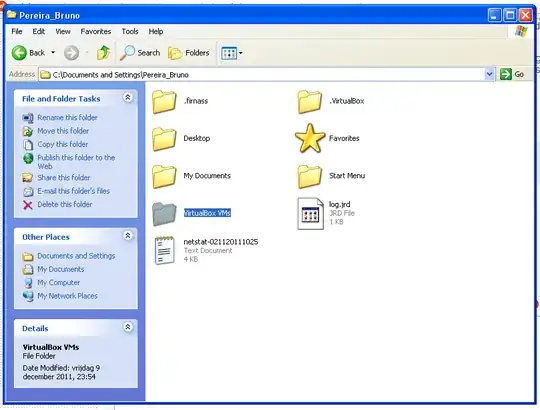

Inside your old Windows installation are 2 folders that you can copy to the new Windows installation that contain all your VirtualBox machines.
The folders are located inside C:\Documents and Settings\<your_username> (for WindowsXP) and inside C:\Users\<your_username> (for Windows7) and are called VirtualBox VMs and .VirtualBox.
One contains the virtual machines disks and the other contains settings.
Copy those 2 folders to the new Windows installation under the same folder names and you will have all your machines restored.
Step by step:
  1. Remove your old disk
  2. Install the new disk and Windows in it
  3. Install VirtualBox on your new Windows installation
  4. Plug in the old disk back and make sure that your computer is booting from the new installation
  5. Copy those 2 folders from the old Windows installation to the new one
