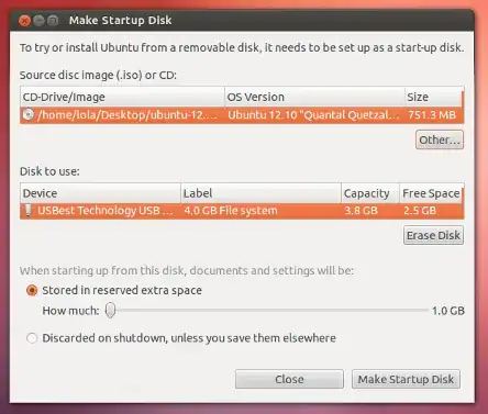

With live CD there is no easy way to do it, however if you install ubuntu on a USB, you will be able to install any application on it.
When you create your USB stick using the Startup Disc Creator there is an option to create extra space for persistent data. If you do that then you can install Cisco Packet Tracer and this will be available next time you boot.

Like another answer said, using a USB with "persistent" would work too, but be aware there was a bug in the persistence where after several reboots (took me a few weeks of daily boots to see it) where the persistent data would get corrupted. It was existing in some debian bug reports since 2007 or so, and still there in 2011. And of course, a CD would need a separate drive/partition to save the persistent data.
