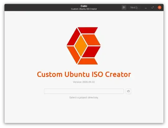

You can use Cubic.
Cubic (Custom Ubuntu ISO Creator) is a GUI wizard to create a customized Ubuntu Live ISO image.
See How to use Cubic to create a custom Ubuntu live CD image? for general instructions.
To install Cubic use PPA...
sudo apt-add-repository ppa:cubic-wizard/release
sudo apt update
sudo apt install cubic
To use Cubic...
  1. Create a new customization project directory.
    Cubic Start Page
  2. Accept defaults for some important parameters, or enter your own values (like file name, release name, etc.)
    Cubic Project Page

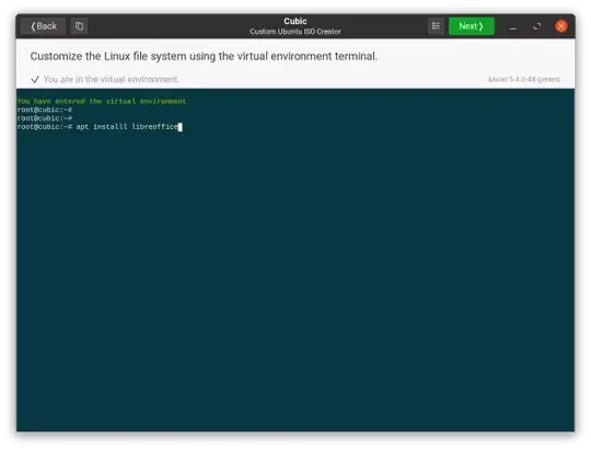

  3. Make your customizations using the command line.
    This is where you will need to be familiar with certain commands. Use apt to install packages, use nano to edit files, and configure defaults such as background and theme (see Cubic Answer 681051 or Cubic Answer 692588 for examples).
    Cubic Terminal Page
