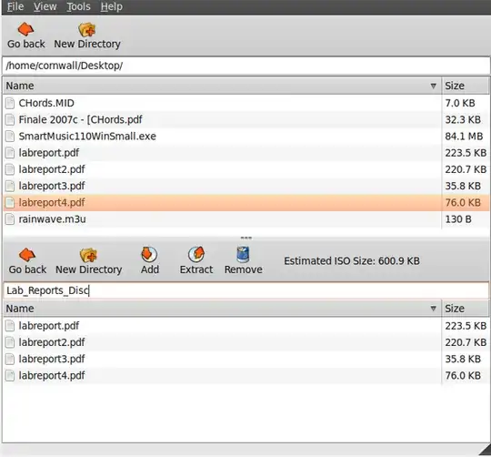

I had used isomaster in the past to add BIOS update programs to a FreeDOS iso. I believe that it is what you want. You can find it in add/remove programs.
screenshot
