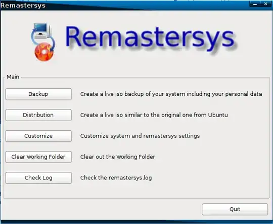

Detail instruction of using remastersys software You can do this by installing remastersys.
Open your terminal, type sudo su and enter.
type wget -O - http://www.remastersys.com/ubuntu/remastersys.gpg.key | apt-key add - and press enter and type your password.
type again sudo gedit /etc/apt/sources.list and in the new opened file add this line at the end of the file.
deb http://www.remastersys.com/ubuntu precise main save and close the file.
If you are using Ubuntu 11.10(Oneiric), replace precise with oneiric. for Ubuntu 11.04(natty) replace precise with natty.
Then run sudo apt-get update in the terminal & sudo apt-get install remastersys.
This will install remastersys software, which can be used to create a CD from your installed system.

Yes ,you can use remastersys for it , Note: It is just backup existing ubuntu installation ,It can't create original ubuntu cd enter image description here
