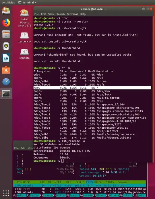

I downloaded ubuntu-18.04.3-desktop-amd64.iso and used mkusb to create a persistent live drive in a 16 GB USB3 pendrive.
When booted persistent live I installed htop and removed usb-creator-gtk (like I did with Ubuntu 18.04.1 LTS as described in a previous comment), and then did [part of] what you describe in your edited question: removed Thunderbird, removed the button for Amazon, connected to Universe and installed stress and stress-ng.
It worked, the modifications persist after reboot. The following picture illustrates what it looks like.
Please notice that you can reboot a persistent live drive made with mkusb live-only, and then it will not see the modifications. The original system from the iso file is still there, but you can mount the casper-rw partition and see the files, where the modifications are stored.
