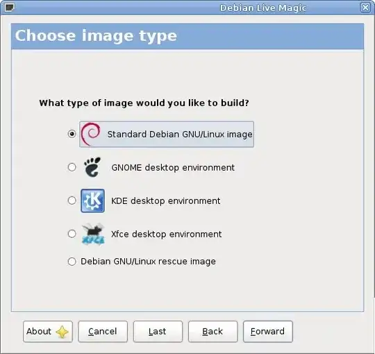

There is a graphical interface
sudo apt-get install live-magic
live-magic
Understand that the live-magic gui may fail, just as remastersys and other guis fail. In that event, you fall back to the live-build scripts (live-magic will generate a build directory).

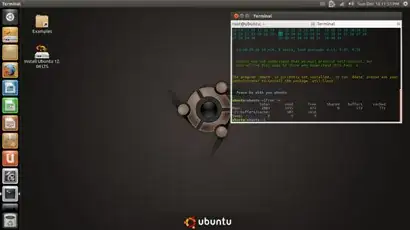

My custom 12.04 build, it supports the gma500, 2d only (no 3d) out of the box (will be making the iso publicly available to the gma 500 crowd in the next few days).
gma 500
