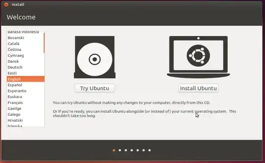

Following the list of instructions here I was able to create a live CD that I can boot (testing in VirtualBox), but I can't seem to find a way to "boot to desktop", skipping the "Install dialog".
Screenshot
I have to wait until the Install app is loaded and then click Try Ubuntu to finally get to the desktop.
Essentially I want to boot to the desktop and also launch an application that I store somewhere in the filesystem. Can I somehow disable Install app from appearing and replace it with an application of my own choosing (that I already store somewhere on the filesystem)?

The SYSLINUX configuration on Ubuntu Live CD is somewhat confusing, but I had figured out by reading this post on Unix.SE and refer to this Syslinux Wiki.
Part A: Skip install/Boot to desktop
To boot directly to Live session, you need to do two things:
  1. replace the default vesamenu.c32 with default live (whose label live is found in /isolinux/txt.cfg file)
  2. comment the last line ui gfxboot bootlogo using # at beginning of line
Step 2 is required, otherwise the initial splash screen will still be visible until timeout. This is due to ui module will override the default setting, as explained in this subtopic on the Wiki:
Therefore, if UI is used, the PROMPT directive is ignored and the UI command -- not the DEFAULT command -- is automatically launched
Default /isolinux/isolinux.cfg
# D-I config version 2.0
include menu.cfg
prompt 0
timeout 50
ui gfxboot bootlogo
Modified /isolinux/isolinux.cfg
include menu.cfg
default live
prompt 0
timeout 50
#ui gfxboot bootlogo
I have tested the modified configuration using Xubuntu 14.04 ISO image, but the same steps should apply to other Ubuntu and official derivatives.
Part B: Run custom app
As for launching the application, it should be doable by adding the path of target executable to the "startup" menu or something similar. For example, on Xfce Desktop Environment, it is found at Settings Manager > Session and Startup > Application Autostart.
Above all, my answer is more toward the solution for "Skip install/Boot to desktop". The latter part "Run custom app" shouldn't be an issue for most users.
For Ubuntu 20+
Remove the ubuntu ubiquity option from the command line.
So in /boot/grub/grub.cfg
Remove maybe-ubiquity or only-ubiquity from the grub boot option. This will take you straight to the live desktop.
