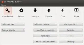

Ubuntu Builder
Ubuntu Builder is a simple tool to build your own distribution. It allows to download, extract, customize in many ways and rebuild your ubuntu images. You can customize i386 and amd64 images.
It is designed for Ubuntu and for its official derivates. However, any distribution based on Ubuntu may be customizable with it.
You can install Ubuntu Builder by downloading the latest version package and installing it with gdebi, ubuntu software center or dpkg. You can also use the subversion repository.
Downloads can be found here
