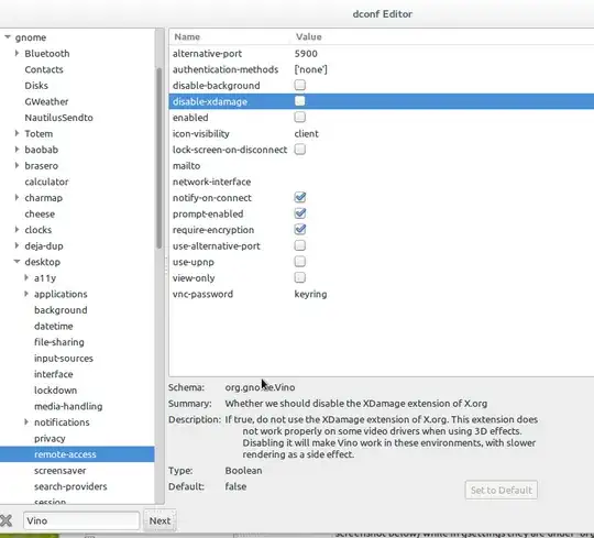

But lately I discovered that the keys accessible from gsettings and dconf-editor are not the same. For example, settings for vino are in dconf-editor under org.gnome.desktop.remote-access (see screenshot below) while in gsettings they are under org.gnome.Vino. There is some documentation that explain the difference?

(0)samsung-romano:~/tmp/try% gsettings list-recursively org.gnome.desktop.remote-access
No such schema 'org.gnome.desktop.remote-access'
But in dconf-editor:
dconf-editor

  • dconf-editor uses schema path to show settings data tree. Same structure used to store data in GVariant database.
  • gsettings (from glib-2.0) uses schema id to show/get settings data. Same way as any other application should do which uses GSetttings API.
  • It's up to the application developer to set both as he/she would like. (with some restriction for canonical naming). So path could be different than id but most application developers prefer to use identical word series/combination. Some don't preserve same capitalization. Example Tracker project from Gnome
    <schema id="org.freedesktop.Tracker.Miner" path="/org/freedesktop/tracker/miner/" />

      <schema id='org.gnome.Vino' path='/org/gnome/desktop/remote-access/'>

    If you noticed, The schema is defined with an id and a path. The schema file name follows the id value.
